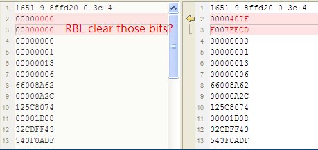

    Yes, now I did as what I did with the C6670.But still the DDR is not well configured.
    1) .gel file is double-checked, the .gel file can well configured the DDR;
    2) ddrCfgTable: all values referenced from .gel file.
    Q1    I found there is a issue.
    I connect to the device via emulator to see the ddrCfgTable value in 0x8ffd20 after reset .
    You will find the first three UINT32 are cleared, so please check if they are cleared by the RBL or should I have some other values not well configured?
    These three UINT32 are so important, they are enable bitsmap.(All the other values are not cleared and correct)
    Please have a try and check the RBL code to make sure the operation.
    Furthermore, how can I make sure the RBL have execute the DDR config function or not?

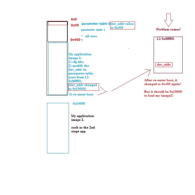

    I have studied the BootROM_c6670_PG1.0 code and found there is a mainEmif4Cfg() function to config the DDR.It demonstrates if there is any config function branch returns non-zero value, the configselect value will be set to 0; so I assume that my three UINT32 configselect to be set to 0 is just this case.But, the values are all from the gel file(gel file is varified), how can I find where  the problem is? So please send my the RBL source code that related with ddr config.
    And it does not make sense that the 6638K2K ROM source code is not open to us ---- the end users, with undetailed docs and uncomplete examples. Our implementation will get more smoothly if we have the source code.
    Q2.
    How to config two parameter table(one for stage 1 and the other for stage 2) in the spi.map file?
    I have try to write two sections in the .map file but it generate two series of parameter tables(each consist of eight parameter tables), but what i want is just one series of parameter table.
    Can you please ask the romparse anthor about this issue and have a try to config two parameter table to implement multistage boot?
    Thanks in advance!

  • Frank,
    Can you please share your code here so that we can reproduce the issue on a K2K or K2H EVM.
    I have another suggestion that you can try and might help you easily debug your DDR configuration issue. Since you have simple code booting in to MSMC, you can initialize the DDR using PDK functions from code loaded in MSMC and then re-enter the bootROM to load the rest of the code.  This scheme is similar to the multi-stage boot that we used in the K2E but instead of using DDR configuration table and ROM to initialize DDR, you will use PDK function.
    This will require you to create 2 boot image one that will load into MSMC and initialize DDR and the second image that will execute from DDR. You can write the first image at the base of the flash memory and the second image at an offset from the base. Before you re-enter the bootROM, you can change the offset from which ROM will read the image to load the second stage by changing the read_addr_msw and read_addr_lsw in the boot parameter table. Check the setting in the file paramsTable.h
    (STAGE_2_BRANCH_ADDRESS >> 16) & 0xffff,	/* The base address to read from the SPI, upper 16 bits */

    I will check with the author of the utility but as far as I know the romparse utility is currently designed for adding only one parameter table. We have provided the romparse utility in the source, so you should be able to modify the utility to meet your usecase. or you can create another utility to post process the output of romparse to add the additional parameter table.
    Rahul
  • I did some experiments with  the romparse utility and was able to add multple boot parameters to the image using the map file attached below:
    https://e2e.ti.com/cfs-file/__key/communityserver-discussions-components-files/791/3426.spirom.map
    Please give this a try and let me know if you see any issues.
    I already have this solution in my mind before I post this question, (can you remember that I made a two image back up boot solution on 6670?similar to this solution), but I would prefer to init the DDR by ROM ,because refer to the .gel file, all the registers to be configured are included in the ddrConfigTable, so I assumed there is no need to have a second initialization in the my user application code if the ROM- ddr- init works. But by now, I am afraid you can not push on this issues more.  From studying the mainemif4Cfg.c , it is clearly the configSelect values are cleared because return err values during configuration, but there is no way to debug the operation ...
    (Please visit the site to view this file)

    I changed the dev_addr to my 2nd image offset as you suggested and jump to [20b00000 _romtReInit] or [20b00008 _romtBootReentry];
    but it just bootload the first image again and I connect emulator to watch 0x8FFF00, I found the dev_addr(in the Memory Browser)  was seccuessfully changed to the second image offset(NOTE! cache writeback opearation is essential). BUT, after BootReentry(), it reboot, and the dev_addr was overwritten as the first image offset,it still bootload the first image.
    Can you have a try? and please test on DSP master boot.
    I thought the parameter table is re-read from  the first 0x80 of FLASH memory, so it is useless to change the dev_addr before re-boot.
    So please explain the detail operation of  _romtReInit() and _romtBootReentry(). Which kind of values/registers will be changed?

  • Rahul,
    I understand that I can change the parameter table in L2, which is located in 0x8FFF00;
    My image and the similar application and problem is drawn below.
    I already have a workaround now.
    But can you point out why the dev_addr is re-read from the FLASH (start 0x80 bytes, which is the parameter table0 in the)? Actually, I tested and found not only the dev_addr , the other values we changed by our application image1 will all overwritten after re-enter boot.
    Please have a test.
