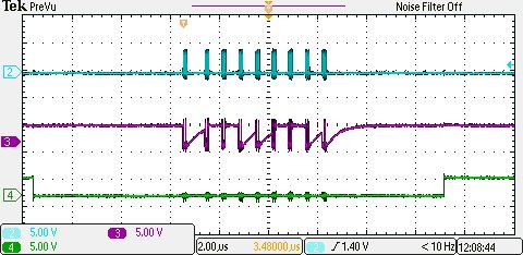

    When I execute:
       echo "DEADBEEF" > /dev/spi1.0
    I can see activity on the spi pins listed above, see scope screen:
    Hope this helps.
