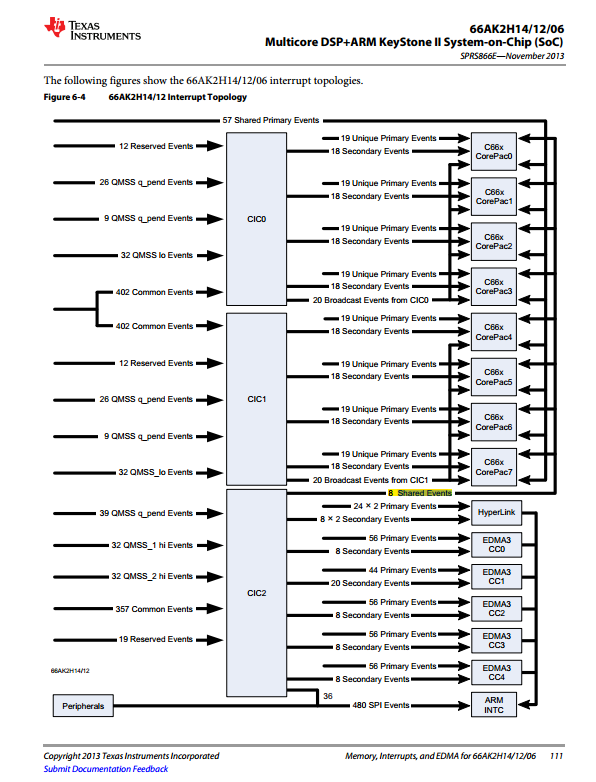

What're Shared Events on the 66AK2H14/12/06
Other Parts Discussed in Thread: 66AK2H14, 66AK2H06, SYSBIOS
The following Figure 6-4 show the 66AK2H14/12 interrupt topologies.CIC2 has 103 event outputs which provides 8 Shared Events to each of the C66x CorePacs, 0 through 7.
I can't fand these on Table 6-22 (the mapping of system events),and host interrupt ID.

    • question 1:
    For 66AK2H14/12 in figure 6-4,CIC2 provides 8 Shared Events to each of the C66x CorePacs, 0 through 7,
    For 66AK2H06 in figure 6-5,CIC2 provides 4 Shared Events to each of the C66x CorePacs, 0 through 7.
    Therer're only 4 system events in table 6-22,what're others?

  • question 1:
    I forward your question to the person who designed the module and here is his response:
    I have only 4 CIC2 events per corepac in the spec. Two are shared across all, each core gets two other unique outputs. So I think that the Figure is wrong.
