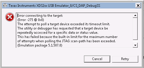

  • Here is the error I get when I try to connect to the target when RESET# is asserted...
    I did find that when I run the "Test Connection" under the Target Configuration it passes and allows bits to circulate in the scan chain while RESET# is asserted.
  • Nuri,
    Emulation trace through RESETz assertion requires certain configuration before RESETz is asserted.  If the device has never exited reset and been properly configured, emulation will not connect while RESETz is asserted.
    Tom

  • Nuri,
    Why aren't you using the wait-in reset method? It sounded like that worked as expected.
    The way RESET# was defined was to allow you to *survive* a reset, not so much to connect while the device is being held in reset. You certainly wouldn't be able to connect to any of the underlying cores while the device is held in reset. One potential option comes to mind... You *might* be able to connect to the ICEPICK while RESET# is asserted. While you're connected I think you should then be able to right-click on the A15 and enable "halt on reset" for that core.
    Brad
  • Nuri Eady said:
    That makes sense. Where can I find info about how to configure the processor after exiting reset so that on subsequent RESETz assertions I should be able to attach?
    I normally just right-click on the A15 up in the debug panel and enable the "halt on reset" option.
  • I am now able to attach to the processor in CCS, enable the "Halt-on-reset" function, perform a System Reset and then attach normally in a halted state before boot code has been run.
    Thanks, very much appreciate the help.
