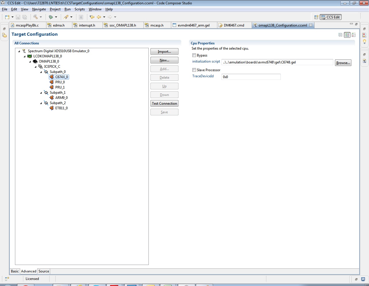

Hello sir,
I am getting an error 0x80000240/-148
error generating by sd scan controller module while connecting to a target throughspectrum digital xds510 parlloel port-pci emulator.
How to resolve this.can you please help me regarding this.

    I think, you have wrongly chosen the emulator connection in the target configuration file (*.ccxml) and kindly select "Spectrum Digital XDS510USB Emulator" and for board or device, select TMS320C6748. If you are using LCDK or EVM, kindly select the device LCDKC6748 or EVMC6748 appropriately.
    As well, after you choose connection and device in the .ccxml file and appropriate gel file can be located at Advanced tab of Target configuration file as from the below get file path:
    C:\ti\ccsv5\ccs_base\emulation\boards\evmc6748\gel
    Click on "Test Connection" button on the target configuration file in order to ensure the sanity check on the appropriate emulation drivers before connecting it to the target.
    Kindly do the above recommendation in order to succeed in connecting to a target device. Kindly check the screenshots attached for your easy reference

  • Which board and emulator are you using ?
  • TMS320c6748(lcdk) board and spectrum digital xds510 parllel port pci emulator.
  • Dear Raghu,
    Thanks.
    Please make sure that you have enabled the PCI emulator driver when you install the CCS.
    Also, this PCI emulator won't work with 64bit based OS (Windows and Linux)
    e2e.ti.com/.../583027
    Please check with spectrum digital website.
