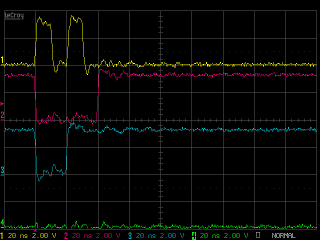

The next picture looks ok in single synchronous read by reading 16bit-length data from GPMC region.
Yellow is GPMC_CLK. Red is GPMC_CS0n. Blue is GPMC_OEn.

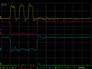

Next picture is two word synchronous burst read by reading 32bit-length data.
This is not what I expect. GPMC_OEn (blue) is 1 clock longer.

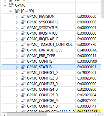

Here is a list of register setting. Could anyone please point out what is wrong within it?
Thanks for reading my post.
