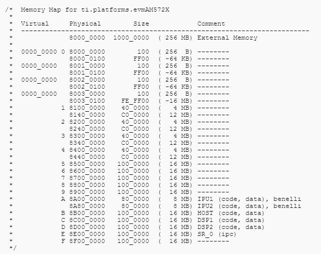

    Follow up question. Can you point me to where the memory map you show above is defined? That seems to me like maybe the Linux memory map for one of the examples?
    What I had found and thought to be the memory map for TI-RTOS for the evmAM5728 was located here:
    C:\ti\bios_6_45_00_19\packages\ti\platforms\evmAM572X\Platform.xdc
    In our case we intend for both DSP's to have a common memory map and then the ARM will map each DSP into physical memory using the MMU's, like this:

  • Chris,
    Yes, the platform definition in Platfom.xdc file found under bios_6_45_00_19\packages\ti\platforms\evmAM572X\Platform.xdc is where the memory map is defined. The overall system memory map has been provided in the comment prior to line 104 in that file.The subsequent lines are used to associate the memory regions and map it to individual cores.
