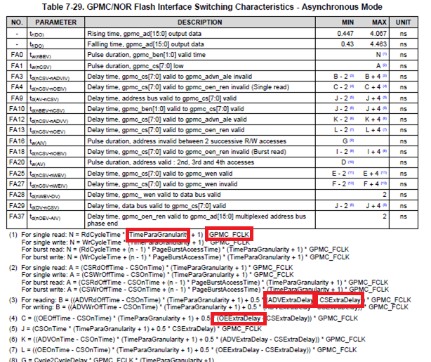

Hi TI Experts,
Please let me confirm the following question.
[Question]
Would you please provide the meaning of "GPMC_FCLK" ,"TimeParaGranularity", "ADVExtraDelay","CSExtraDelay" and "OEExtra" on Table 7-29 in datasheet?
