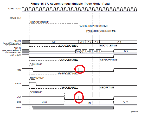

According to the Figure15-77 on TRM, there is the short pulse on nCS and nOE line when A0 transits A1. Does it always happen?
If you have any questions, please let me know.

    As for your second question:
    There shouldn't be such pulse in the CS & OE lines. I've tested the interface of the older Sitara devices (GPMC IP is the same), and haven't seen such pulse on CS & OE. I will confirm this with the TRM authors, but IMO this is an error, when drawing the diagram.
    Yordan

    I confirmed this. As I said it is a mistake in the diagram. It will be fixed in future releases.
    Yordan
