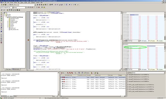

    RandyP said:
    Screen shots from CCS with the different cache visibility options selected may be helpful.
    I can see L2 is cached in L1D when I use cache visibility in memory window.

    • When I uncheck I saw all the data is transfered correctly - in this case all of them are 2 just after the transfer.
    Something new:
    When I debug step by step, L1D cache is updated correctly after the transfer even I do not use any cache commands. But when there is no break point after the transfer, I realized that first 1-2 elements are miscalculated. I changed the size, the case is same.Even for SIZE=2! Again the two elements are miscalculated. When I uncheck L1D cache from memory window, all values are "2". Below is a screenshot of this issue.
    By the way, thanks for your interest...
