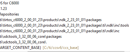

    BTW, to address this undefined error, you can add the NDK package to your CCS settings.
    Refer to the following TI e2e post.
    e2e.ti.com/.../863166
    Thanks for the reply. I can run the example programs with the corresponding exe program just fine. For example running client.c with echoc.exe. Echoc.exe creates an array and then sends it to the DSP and receives it back (am i right?). This works fine but I'm looking for away to load an array into the ethernet buffer on the DSP and send it to the PC to be read from the cmd line(through a program like echo.exe) or preferably through MATLAB. The essential part is to generate the array in the DSP, load it into the buffer, and send it (or make available for retrieval). Btw when I open up an example program such as client.c, all I see is BIOS_Start(). I can't find any info about this function although I imagine it starts up SYS/BIOS on the board. Do I need this in my code?
    I have also already added the NDK package to my CCS Settings but still get the same errors. (btw the name of the program is userMade...just in case the error msg was misleading).
