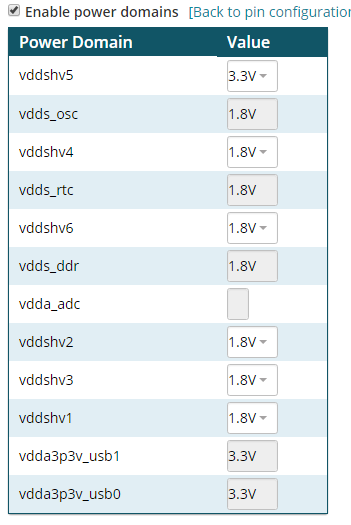

Is this a bug in the cloud pinmux tool? VDDSHV5 is 3.3V but MMC1 is 1.8
First things first.   I noticed that on power up, the 3.3v rail rises slightly when only 1.8V is on (this is during the sequencing)
So we have been chasing this down.  My astute colleague noticed that the VDDSHV5 rail is connected to 3.3V, yet we are using 1.8V pull-ups on the MMC1 lines.  The pinmux tools claims that MMC1 is configured as 1.8V, and it is configured so that VDDSHV5 is 3.3V.   Is this not in conflict?
