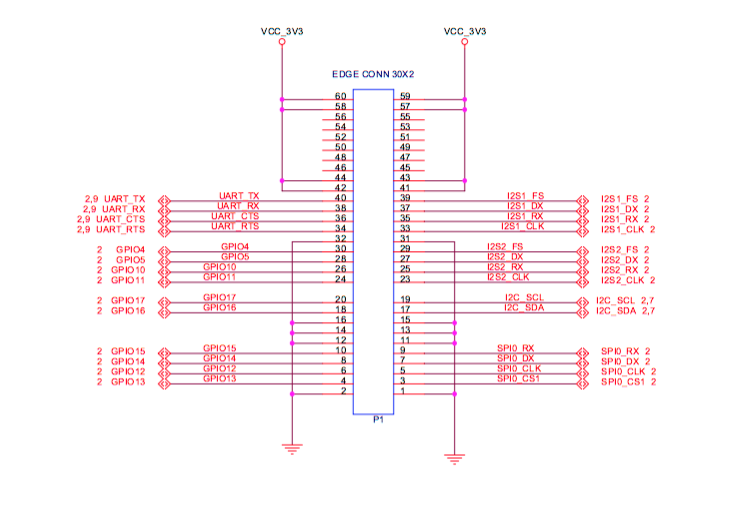

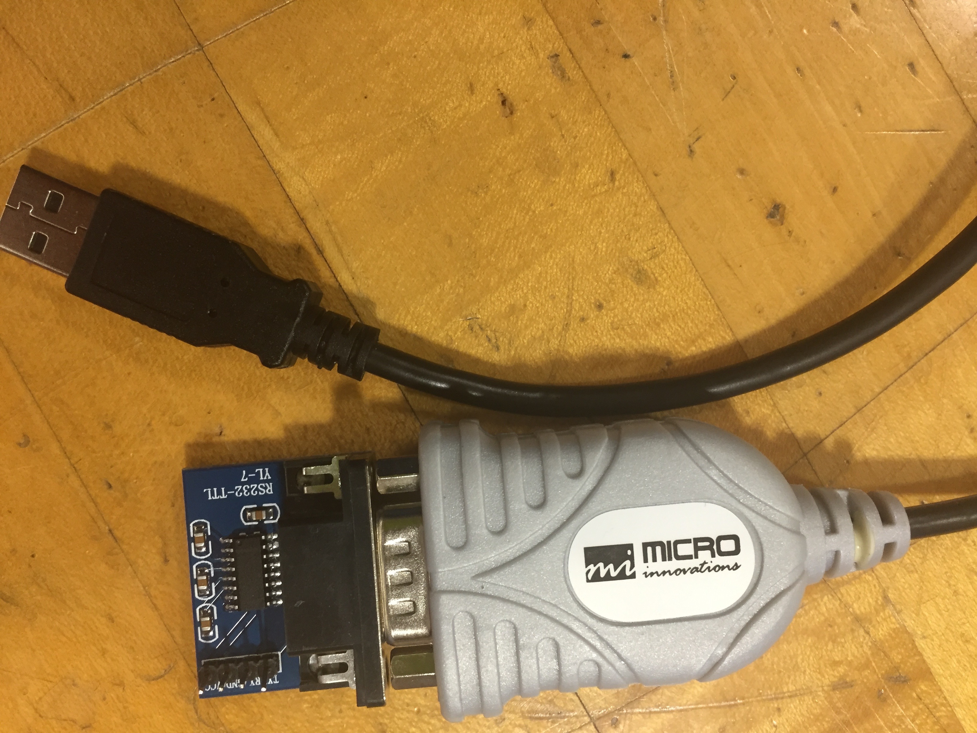

Using the UART in the C5505ezdsp REV C, I figured that the UART is not connected to the USB and that the output of the UART TX and RX are in the expansion connectors (as seen in the figure bellow). So I went ahead and soldered the pin 40 and 38 and then connected it to a max 232 chip which is outputed through DB9 connector. And from the DB9 female connector I used a serial to USB cable to transmit the information to the computer. Using the UART example provided, I tried to output what is expected on the terminal but nothing was functioning as expected. My question is I don't know whether I am setting up properly so that I could output the UART? Or maybe I am not using the proper code?
Thanks in advance for your help.
Figure 1: max 232 and the serial to usb cable
Figure 2: The c5505ezdsp connector
