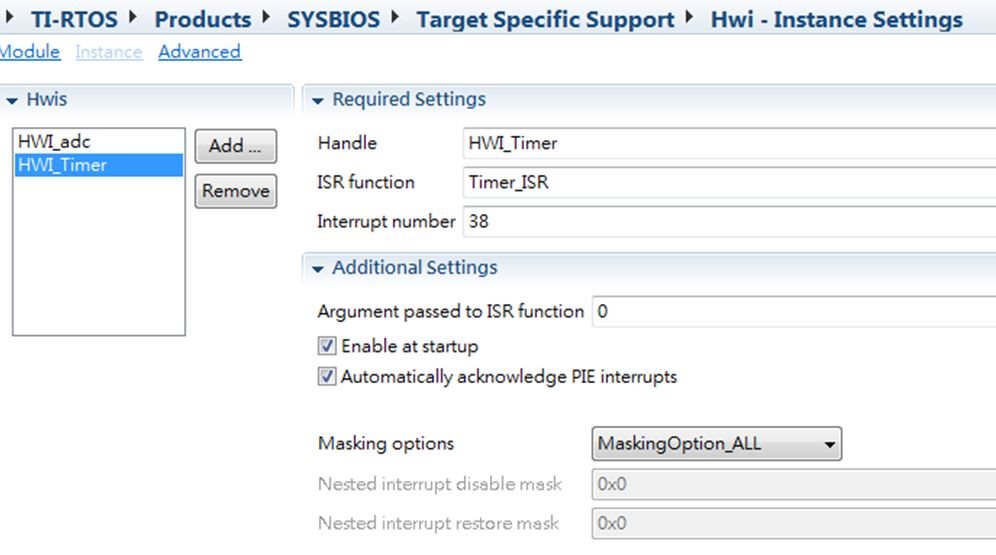

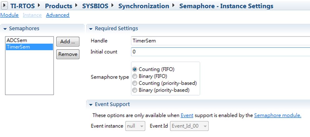

interrupt problem by using the TI-RTOS on F28069
I have two interrupt source. [one is adc interrupt(running 15KHz), another is timer interrupt(running 1KHz)]
It can work independent, but not work simultaneously after about 10 minutes......
Below is my code process:

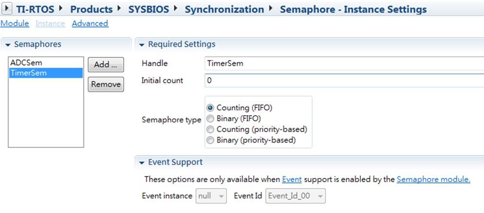

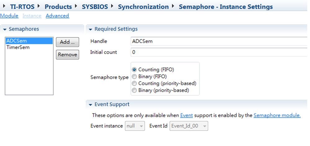

  Hwi                             Semaphore                   Task
1.adc_ISR     ----->       ADCSem        ----->        adc
2.Timer_ISR  ----->       TimerSem      ----->       Timer

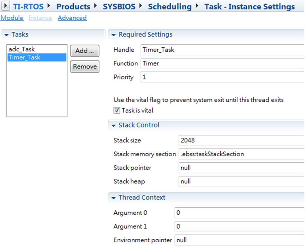

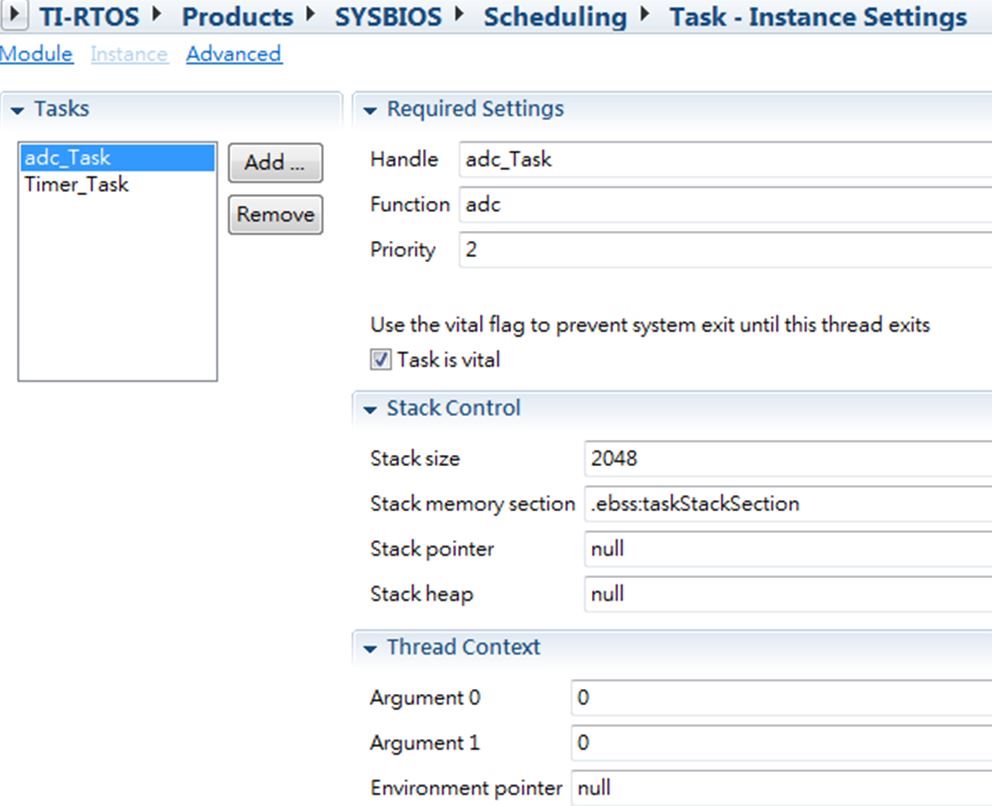

My adc task priority higher than timer task priority.
Have anyone encountered similar problems???
Please help. Thanks a lot.

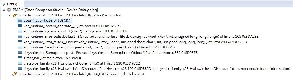

When interrupts do not work, I press the suspend bottom.
It always in the abort() function.........
Below picture is my debug window:
Below picture is my RTOS .cfg setting:
