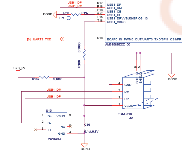

My target board has an AC power supply and battery.
When AC power is turned on, USB is properly detect.
( boot on AC power turned on status )
But, after AC power turn off(VBUS : 3.7V) -> on(VBUS : 5V), USB didn't detected.
How to reset the USB module?
/proc/driver/musb_* doesn't exist.
