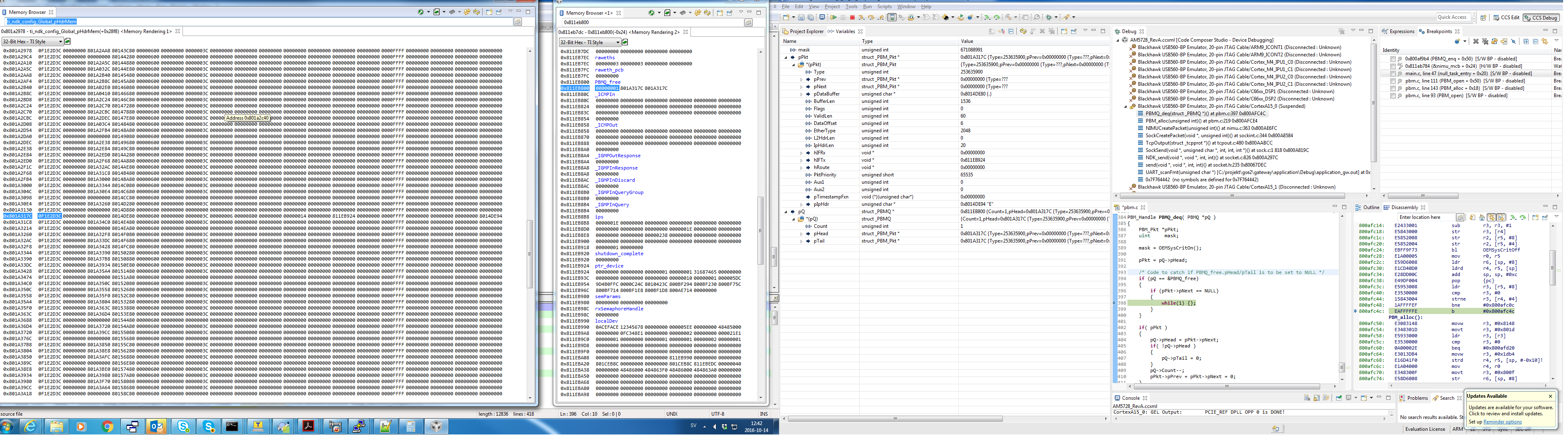

Hi. I have found a strange behaviour when I send data from an windows 7 FTP client to our small ftp server that is built on the NDK.
Just to be sure that our large application doesn't do something strange, I integrated the code into NIMU_BasicExample_evmAM572x..., with the same result.
When I send a file that has a 2k size everyting looks fine in wireshark.
If I switch to a 4k file I always get one retransmission.
Each time I increase the filesize (double the size) I get more and more retransmissions.
The throughput is realy bad. Any hints what can be wrong.
I attach 3 screendumps, 1, 2k and 32k transfers fron wireshark and corresponding cmd-prompt that was running the ftp client.
I can provide the CCS testcode also.

  • Sorry for any delay...I am escalating this post.
  • I want to inform that our apps team was able to reproduce the issue and they are working on it. More comments will be posted here soon.
  • Per-Anders,
    The TCP re-transmission appears to be addressed after updating the followings in nimu_evm.cfg. Would you try the same on your system and check if any FTP connection and throughput behavior changes?
           Mmu.initDescAttrsMeta(attrs1);
           attrs1.type = Mmu.DescriptorType_BLOCK;    // BLOCK descriptor
           attrs1.shareable = 2;                  // sharerable
            attrs1.attrIndx = 1;                       // non-Cached, normal memory, original value 2
    Regards, Garrett

  • Per-Anders,
    Yes, we also observe the TCP re-transmission if setting TCP buffer size to default 8192 and transferring a large size data as what you tried, thought 'A lot of errors' you described is a new issue after cache is disabled. We have been looking into the cache operation to packet buffers/descriptors, and modifying packet receiving ISR but don't have conclusion yet at this point, will update you as soon as we can.
    Regards, Garrett

    I have run into another NDK problem. It seems that if we are calling send() in a very tight loop, the NDK will crash in the PBMQ_enq() function.
    The Pq->pTail->pNext pointer is NULL.
    I have tracked this down (and think) it happens when PBMQ_free list runs out of buffers. I've put some code in the PBMQ_deq () function to break if the
    PBMQ_free.pHead and PBMQ_free.pTail is to be set to NULL. The PBMQ_free.Count is in this case set to "1" (Last free item ?).
    I attach some screendumps of memory views and stack traces.
    I hope this can make it easier for you to understand the problem.
    If I make a Task_sleep(1) between the send() calls, this never happens.
    BR:
    Per-Anders PBMQ problems.zip
