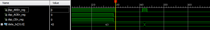

Asynchronous signals (AREn ACEn & AOEn ) become inactive after transferring first element by EDMA when using FS=1;
  I have interfaced a FPGA with DSK6416 by using a ASRAM interfacing technique. When transferring data from EDMA configured as
EDMA_Config myConfig1 = {
0x21200001, // Frame Synchronized 1D-to-1D Transfer
0xA0000000, // Source address (Asynchronous Memory - FPGA)
0x00020004, // No of frame for transfer(16 bit)-1 || No of element per frame
0x80000000, // Destination address (On board SDRAM)
0x00000000, // Offset after frame
0x00040000 // rld
EDMA_config(hEdma1,&myConfig1); // Configure EDMA with parameter of myConfig1
EDMA_enableChannel(hEdma1); // Generating interrupt EER
The read enable signal goes high only for first time then it become inactive? What could be the issue?

  • Shehzad,
    Have you tried reading from this source address using the DSP? In particular, try a test with reading from a long long pointer, such as
    volatile long long *p = (long long *)0xA0000000;
    volatile long long var1, var2;
    var1 = *p++;
    var2 = *p++;
    *p = var1+var2;
    It would be good to see what the traces look like for this case, also.
    The problem you are seeing is more likely related to the EMIF configuration than to the EDMA operation. You will want to carefully examine the EMIF Configuration registers. Also, look at the EMA_WAIT signal.
    [FYI, I am used to an active low signal like AREn being called inactive when it is high and active when it is low. This confused me when I read your title and then looked at the picture. Or else there is more to the right of the picture that I cannot see, past tick 70. Just saying.]
