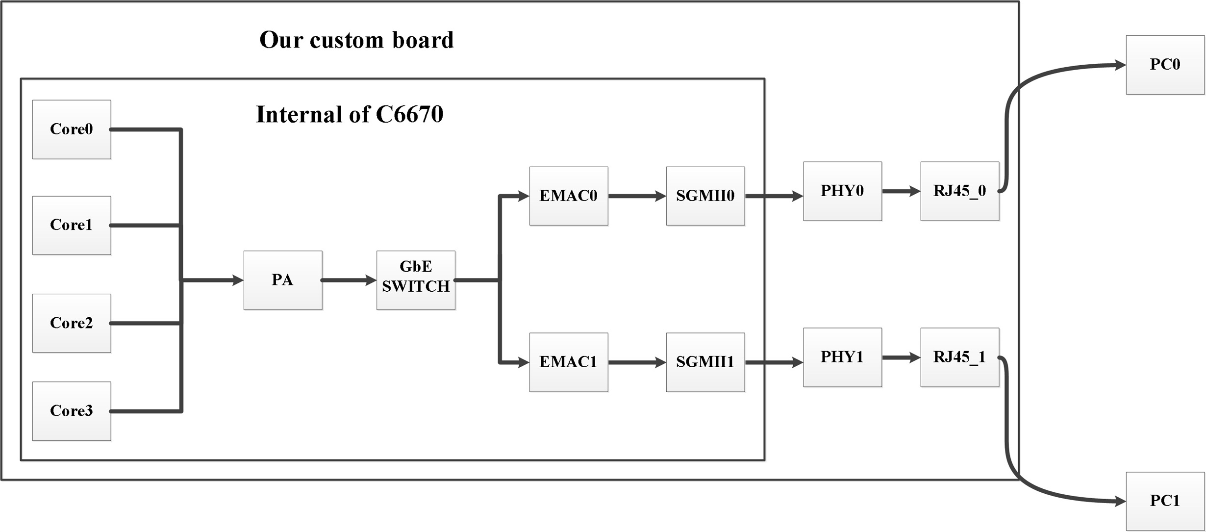

Hi all,
Software environment: C6670, CCSv5.3, MCSDK 2.1.2.6, MCSDK PDK TMS320C6670 1.1.2.6, NDK 2.21.1.38.
On my custom board, the C6670 is connected to two PHYs(88E1111) using SGMII0 and SGMII1 ports respectively. The followed figure shows some details of my board.
What I want to implement is that using the C6670 as a DHCP server and when I connect two PCs these two PCs can achieve their own IP address and DSP Core0 works as another DHCP client.
I mean three parts are connected to the GbE switch. One is DSP Core0 and the other two are PCs. GbE switch is used as a router which has a DHCP server can assign IP addresses to the DSP Core0 and the two PCs.
How can I implement this using NDK?
I had changed the codes like this attached file

The DHCP server configuration codes are like these
CI_SERVICE_DHCPS dhcps;
CI_ROUTE RT;
// Specify DHCP Server Service on IF-1
bzero( &dhcps, sizeof(dhcps) );
dhcps.cisargs.Mode   	= CIS_FLG_IFIDXVALID;
dhcps.cisargs.IfIdx  	= 1;
dhcps.cisargs.pCbSrv 	= &ServiceReport;
dhcps.param.Flags	= DHCPS_FLG_LOCALDNS;
dhcps.param.PoolBase	= inet_addr("192.168.1.100");
dhcps.param.PoolCount	= 10;
CfgAddEntry( hCfg, CFGTAG_SERVICE, CFGITEM_SERVICE_DHCPSERVER, 0,
                     sizeof(dhcps), (UINT8 *)&dhcps, 0 );
bzero( &RT, sizeof(RT) );
RT.IPDestAddr = inet_addr("192.168.1.1");;
RT.IPDestMask = inet_addr(LocalIPMask);
// Add the route
CfgAddEntry( hCfg, CFGTAG_ROUTE, 0, 0,
            sizeof(CI_ROUTE), (UINT8 *)&RT, 0 );
When I ran this codes as DHCP server, the console printed the results as below
QMSS successfully initialized
CPPI successfully initialized
PA successfully initialized
Wavepop K7_C6670 Board TCP/IP Stack Test Application
DHCP Server start...
Service Status: DHCPS    : Failed   :          : 000
Can anyone give me some hints to resolve this problem?
Feng
