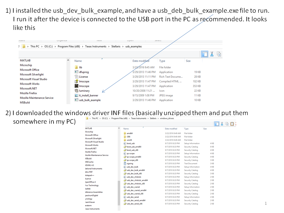

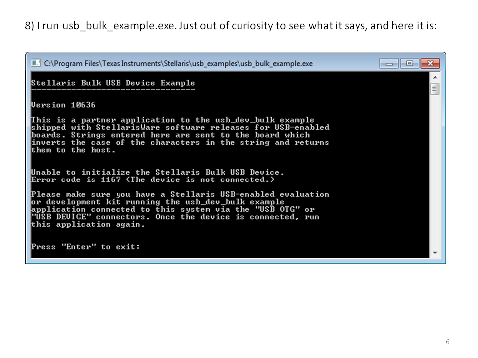

PC running Windows XP SP3 detects device and ask for driver. I point it to the folder where I unzipped all the .inf and catalog files. It seemed to have installed driver successfully. Then it says USB device not recognized. So I run the usb_bulk_example.exe application and it complains with error stating that no device is connected, go connect device and try again.
I have tried this on four different machines. Windows 8.1, Windows 7, Windows XP, and Windows Vista, and none recognize the device (board running usb_dev_bulk.out). They all detect it and finally say " USB DEVICE NOT RECOGNIZED", unknown device. So I am not able to run the example. I have tried uninstalling it and updating the driver, restrating several times etc, with no luck, It is always unrecognized.

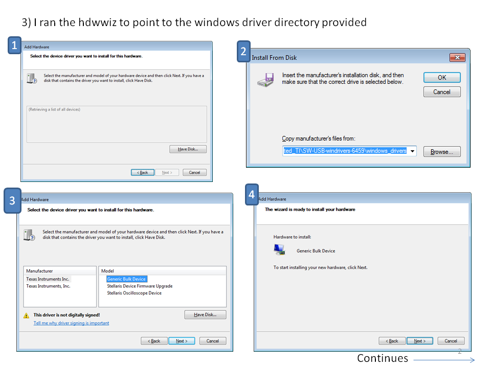

On Windows 7 I tried running the hdwwiz and installed the Bullk Device by pointing to the Windows driver folder provided by TI (I took this from a previous post from Norman Wong). It does install it, but complains about Code 10, not being able to start it (this without the board connected or not).

    Just post me the screenshot of the messages you received on the UART terminal ( i.e., tera term ) after you ran the dev_bulk example on the target.
  • Hi Shankari, thank you.
    Just to confirm, I have the TMDXLCDK138 (USB OTG connector J2) ------- usb cable ------- PC setup. I have not been able to transfer data. I understand the usb_bulk_example.exe provided (once it's working) will send some characters I type to the board, the firmware will change the case of the characters and send them back to the PC where I will be able to see them with their case changed. I thought all I needed was the usb_bulk_example.exe application for this. Again, as described in the Starterware USB site on the Bulk device transfer section. I am not sure what role the UART or the Tera Term plays in all this, perhaps that's my missing piece?. In any case, this below hopefully explains more of what I am doing.
    Below I am attaching some of the screenshots I see, hopefully it makes sense. I tried to put them in some logical order.

    In your step number 7, right click on the "Generic bulk device" , click "update driver software and locate to "~\SW-USB-windrivers-6459\windows_drivers" in your host PC.
    You have to loacte where the file, "usb_dev_bulk.inf" is available. This will install the appropriate driver.

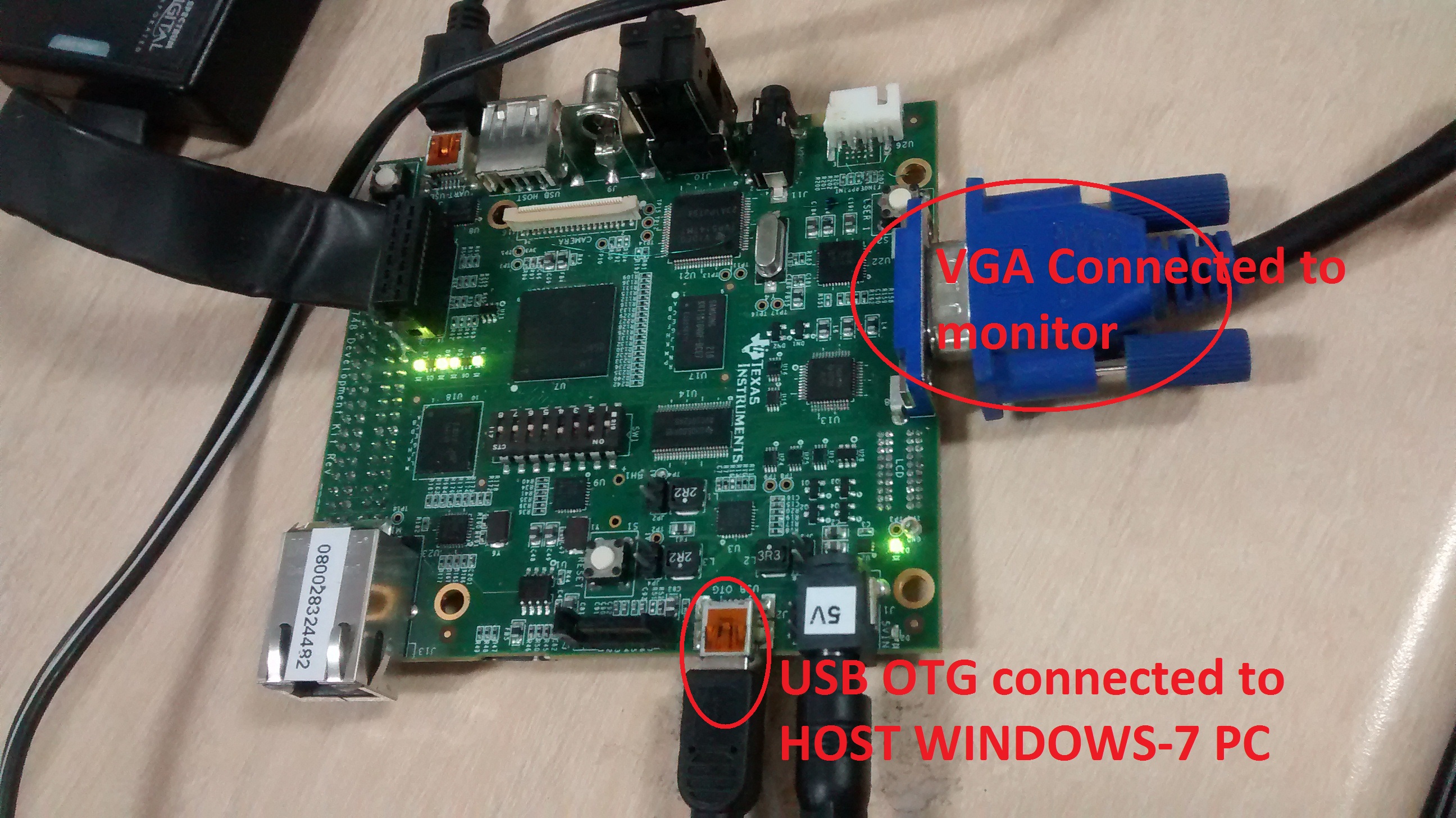

    How to run the USB device bulk?
    1. Connect a VGA monitor to the OMAPl138 LCDK board.
    2. Run the USB dev bulk example on OMAPL138 LCDK. ( Make sure the Jumper next to J2 is removed for device mode operation)
    3. Download the "SW-USB-win-10636.msi" and install it. This wil provide the windows device bulk application for the host side.
    4. Download "SW-USB-windrivers-6459.zip". This will have drivers. Download link : www.ti.com/.../sw-usb-windrivers
    5. Open device manager and install the driver for "Generic bulk device".
    6. open and run the usb bulk example.exe and send the data by typing the strings in the host PC.
  • Hello Shankari, thank you .
    I did not have to do all of what you suggested at the beginning of your previous (last) message, mostly because I already did it before.
    This time I did this:
    1) I downloaded the same firmware to the target and ran it (using CC6 v6.x),
    2) I plugged the board (LCDK) to the PC USB port running Windows 7, the PC (for some reason) this time installed the driver successfully (I did not have to point the PC to any location for the drivers, it must have remembered where they were from my previous attempts). It installed Generic Bulk Device successfully this time, and I am able to see it on the control panel fine with no errors or exclamation sign. Checking its properties on Control panel it states the device is working properly, which is always a good sign.
    3) I connected the Monitor via VGA and, could see the same sort of screen you have on your image above with the Host Connected, Tx bytes, Rx bytes. messages...
    4) I ran usb_bulk_example.exe. It ran successfully this time, I am able to type a string in the host pc Windows 7 on the cmd prompt provided by usb_bulk_example.exe, I hit enter and see the number of Tx and Rx bytes transmitted and received on the monitor connected as you pointed in your message. The message back from the LCDK has changed cases, which is expected,
