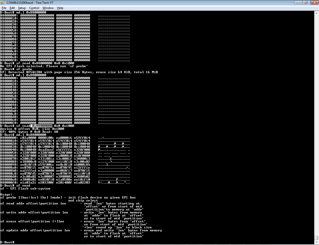

  • Okay, 2 updates:
    We figured out how to run the platform test.
    And we confirmed that "sf write" is working as expected. But when I try to boot from SPI, it is reading the SPI data correctly (our scope saw the correct bits on the wire) but failing to boot successfully. Both for the 'u-boot-spi.gph' and the 'u-boot.bin' that was formatted for spi using 'fmtimg'.

  • Dear Samuel,
    It seems SPI HW connection is good. We can check the SPI boot later since we don't workable u-boot binary as need changes on NAND, Ethernet etc., so it may need some changes for successful boot.
    SPI flash method:
    1) Booted and got u-boot prompt from NAND or CCS.
    2) And here is the step to update the u-boot on SPI.
    tftpboot 0x88000000 u-boot-spi.gph
    sf probe
    sf erase 0 0x100000
    sf write 0x88000000 0 0x100000
    The platform_test from 'C:\ti\pdk_keystone2_3_01_04_07\packages\ti\platform\evmk2e\platform_test' unmodified, prints nothing when run.
    You will get the output logs on UART.
    I would like you to suggest to try first on EVM board then try it on your custom target board.
