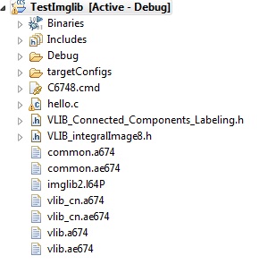

My project in CCS 5.3 looks like the follow image

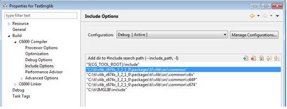

By the way, I change the compiler and linker option (see below) in order to include all the libraries and header files.
