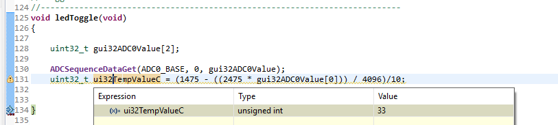

void ledToggle(void)
uint32_t gui32ADC0Value[2];
ADCSequenceDataGet(ADC0_BASE, 0, gui32ADC0Value);
uint32_t ui32TempValueC = (1475 - ((2475 * gui32ADC0Value[0])) / 4096)/10;//convert to Celsius

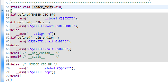

The following are two outputs, one is a breakpoint just after ui32TempValueC, and the other, is after I click resume.
 , now when I click continue, this is what happens:
What am i doing wrong with the ADC???
