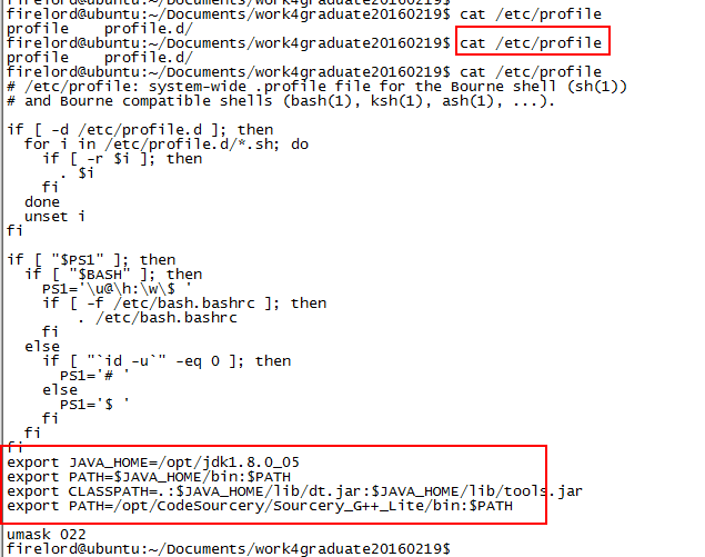

  • hi,
    I have installed the codesourcery. And I have add the path to the /etc/profile. As showing below:
    And here is the steps I am using:
    make CROSS_COMPILE=arm-none-linux-gnueabi- ARCH=arm distclean
    make CROSS_COMPILE=arm-none-linux-gnueabi- ARCH=arm ti8168_evm_defconfig
    make CROSS_COMPILE=arm-none-linux-gnueabi- ARCH=arm menuconfig
    make CROSS_COMPILE=arm-none-linux-gnueabi- ARCH=arm uImage
    make CROSS_COMPILE=arm-none-linux-gnueabi- ARCH=arm modules
    make install(In the first five steps, they are all good. But whne I did this step, there comes many choices like I post in the earlier post.)
    for help. Thank you.
