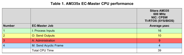

Our customer tried the benchmark test for EtherCAT Master using TMDSICE3359 in reference to TI Design below.
Acontis EtherCAT Master Stack Reference Design (TIDEP0043)
The benchmark result in the TI Design is as follows.
EtherCAT Master Stack for TI Sitara CPU Family Design Guide
8 EtherCAT Master Benchmark
9 Test Data
The benchmark result of the customer is as follows.
When default MMU settings that the DDR3 memory attribute is non-bufferable are used, it shows the performance that is lower than the TI Design.
SYS_MMU_ENTRY applMmuEntries[] =
   {(void *)0x08100000, SYS_MMU_CACHEABLE},   // Non bufferable| Cacheable
I: Process Inputs = 35.5
O: Send Outputs = 36.4
A: Administration = 49.4
M: Send Acyclic Frame = 12.1
When custom MMU settings that the DDR3 memory attribute is bufferable are used, it shows the performance approximately near the TI Design.
   {(void *)0x08100000, SYS_MMU_CACHEABLE | SYS_MMU_BUFFERABLE},   // Bufferable| Cacheable
I: Process Inputs = 14.1
O: Send Outputs = 10.8
A: Administration = 9.8
M: Send Acyclic Frame = 1.7
Why do the default settings show bad performance?
Do the optimization method in the custom settings have any problem?
They want to know the MMU settings used in TI Design. If other optimization method is used, they want to know it.

    DDR MMU settings Cacheable|bufferable sounds correct. Typically using "Bufferable" setting in the memory on which the code is locate helps to increase performance. I don't think there is any other optimization that was used but I will double check with Acontis.

  • Hi Maeda-san, it seems default MMU settings were used for benchmarking, in other words not "buffereable" setting for DDR. Could you please let us know which building settings did you use? (specifically which optimization level?)

  • Daisuke-san, In order to see if software versions has any impact we would need to re-do profiling..
    A note, Acontis EcMaster library V2.7.2.12 for SYSBIOS was build using optimization O2 and 1.1.0.3 IASDK, but in our TI design we used 1.1.0.8. Your customer could give a try to IASDK 1.1.0.3 as a test.
    A couple of questions:
    - Is your customer using same bus slaves? same frame size? etc.. Different bus and conditions could be the cause of the observed performance differences.
    - Has your customer any issue on using MMU bufferable for DDR section? if not, could they use this attribute to improve performance?. We did a sanity test using EC-Master with DDR "bufferable" and it worked OK. It shouldn't be any drawback on using this memory attribute.
    Thank you,
    Paula
  • Hi Daisuke-san, Acontis help us to do a sanity check using EC-Master lib with am335x_sysbios_ind_sdk_1.1.0.8 and am335x_sysbios_ind_sdk_1.1.0.3. They reported that with 1.1.0.8 buffereable gives indeep a performance gain and for 1.1.0.3 buffereable and non-buffereable results are the same performance. We are suspecting for 1.1.0.3 there is bug and memory attribute is always set as buffereable..
    In summary, please suggest your customer to use buffereable. I hope this help to clarify. Thanks for reporting this, for the next EC-Master TI design we will add MMU settings and building optimization flags so it would be easier to reproduce result.
