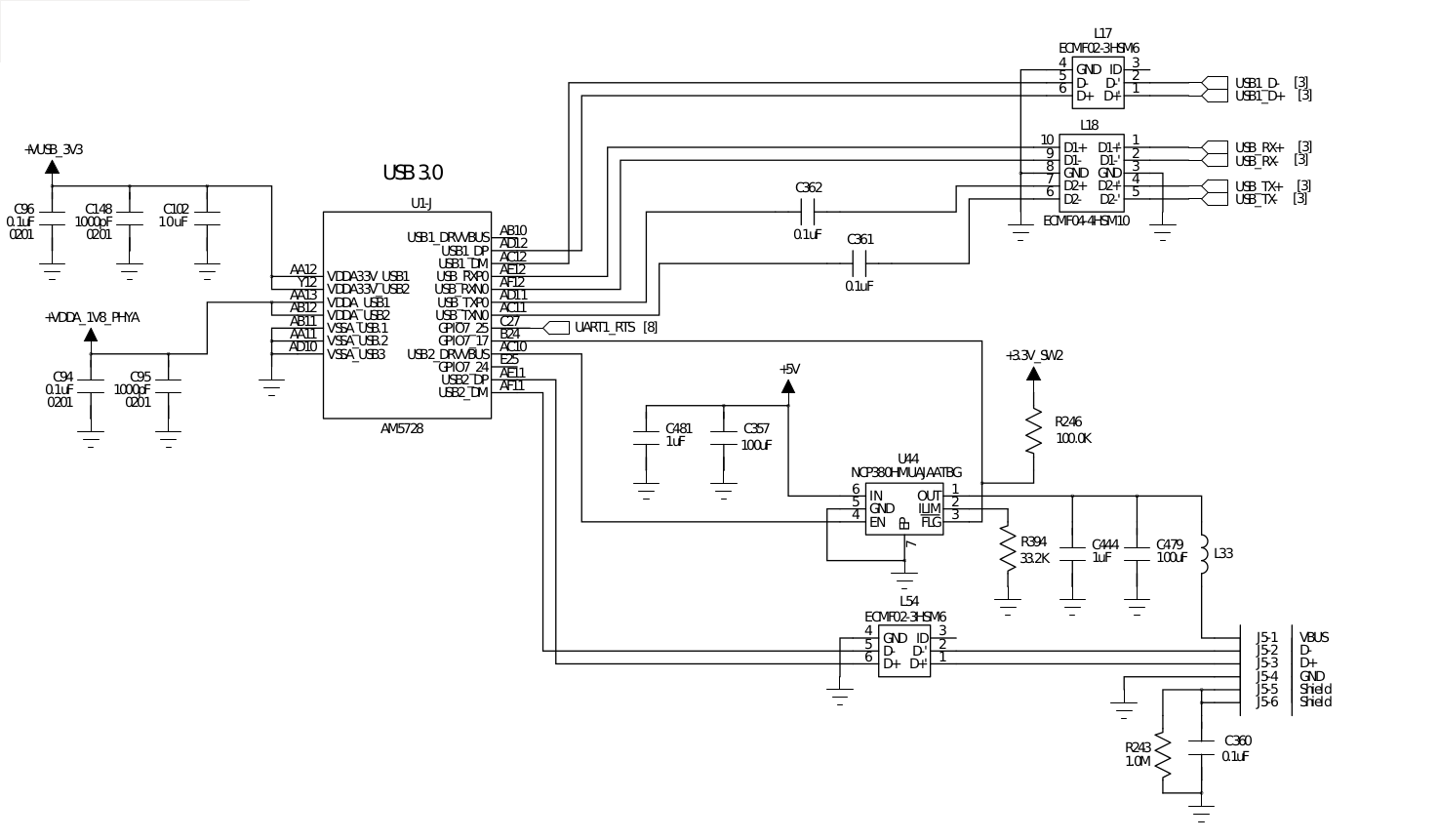

  • Dexter,
    I am not in the part of the schematic review process. Can you please post the usb portion of the schematics? I'd like to see your change to the usb2 port.
  • Bin,
    Attached is USB portion of the schematic.  Note that I am currently concerned with USB2.  USB1 (configured as a 3.0 host) will not come online until our next board revision.
    I have also tried a couple of other things that may be of value.
    1) I moved to u-boot from the ti-sdk 2.0.1.07 only changed the dmm_lisa_regs value to match our RAM configuration.  I did this because some online reports by Robert Nelson implied that some version of u-boot would "break" USB for the kernel.  My test results are identical with u-boot from ti-sdk and u-boot from tag 2015.07 from git.ti.com/ti-u-boot.git
    2) I modified the device tree to remove the palmas extcon usb, as this more closely matches our schematic.  Results are the same with the dts i previously posted and the one posted here now.
    Finally, we are doing a small board revision for unrelated issues.  If we need to change the USB schematic it would be very important to have that finalized by early next week.

  • I was hoping for a bit more direction in terms of what might be wrong in the device tree.
    Attached is a new device tree file that recreates the issue with a minimal number of changes to the device tree relative to the beagle x15.  My changes were as follows...
    1) disable hdmi.  My board does not have any hdmi.
    2) remove references to sound, i don't have sound and leaving it in the device tree causes unrelated crashes trying to probe mcasp3.
    3) change usb2 dr_mode to host.
    I still get the same crash.
    Given my schematic, host only with no id connection and usb2_drvbus connecting directly to the switch without feedback through the PMIC can you help figure out what the devicetree should be?
    Thank you
    Dexter

  • Dexter Travis said:
    As I understand it, in host mode the AM5728 uses the usb2_drvvbus pin to enable and disable vbus to the port through an external switch or power supply.
    Yes, that is the intent of the usb2_drvvbus when using USB2 as a host.  I see your design has connected this to a power IC as expected.
    Do you ever see your IC being turned on and providing the necessary 5V?  I suspect that since the EVM was not using this pin, that it was not ever being configured.  Along those lines, it would be useful to see the value of the register CTRL_CORE_PAD_USB2_DRVVBUS (address 0x4A003684).  You could potentially grab this with JTAG or if you can disable USB to actually get your board booted you could do "devmem2 0x4A003684".
    Dexter Travis said:
    You have bypassed this function by supplying vbus manually.
    We don't have an IC on our EVM to produce 5V.  USB2 was intended to be a device where the 5V was an input which we detect.
    Dexter Travis said:
    Do any of your other EVMs have examples that were designed from the beginning for host mode on this port?  Will you please share schematic and devicetree information for these boards?
    I had a look at our automotive EVM, but unfortunately it's nearly equivalent in that USB2 was designed as a device port.

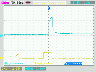

    The image below is what I see immediately after power on.  I think this is a power on glitch followed by u-boot turning on vbus.  All that is in this image occurs before the kernel starts to load.  After this point the line is always low.
    Yellow is the vbus control line, blue is vbus itself.

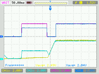

  •  I was able to capture a scope trace of the 3.3v USB output of the PMIC during a "working" boot.
    I am able to twiddle the power connection such that by watching the scope and quickly connect/disconnect power at a boot I can get it to "work" the line goes all the way to 3.3v.  During initial boot up it goes to an intermediate voltage for a little while.
    If I just apply power from a cold state and do not twiddle the power connector I see zero activity on the VDDUSB line (flat line).
    Attached is the twiddled power working case.
  • Can you get a scope shot of LDOUSB_IN relative to LDOUSB_OUT during the ramp up? It might also be useful to see the PMIC's RESET_OUT signal. I was trying to correlate some of the activity on LDOUSB with other events, and I think releasing the processor from reset is probably a decent guess.
    If possible, please provide a screenshot for a bad case (0V) as well as the "eventually successful" case.

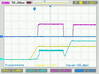

  • FAILING CASE 1
    pink is pmic reset out.
    yellow 3.3v going into the PMIC for the other LDOs.
    light blue is the LDOUSB_IN line between D9 and the PMIC
    dark blue is USB3v3_OUT

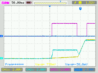

    Failing Case 2
    All lines same as case 1 except yellow.  Yellow is now 5V before D9.  Schematically Yellow feeds through D9 to light blue.
    Based on these observations it appears the PMIC is allowing voltage to bleed through internally from the 3.3v LDO inputs to the LDOUSB input.
    The LDOUSB_IN is only connected to D9 and the PMIC and some caps.  D9 selected between mains power and battery power.  The battery is not installed and at the time this net goes high (to 2.16 volts) there is no voltage on either 5V or the battery line. (I also took scope shots of the battery line not shown).  It seems that first hump in light blue must be coming from a back feed from the PMIC internally.

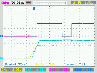

  • I modified the board so that 5V and 3.3V come up roughly at the same time and took the external MCU out of the circuit (it was delaying 5v enable).
    So far the results look very promising.  I am about 5 out of 5 good resets from a cold state.
    yellow = 3.3v  (ldo inputs to other ldos on pmic)
    light blue 5v (ldousb pmic input.)
    pink (pmic_reset_out)
    dark blue (ldousb_out)

    Attached are some scope captures.
    This is the zoomed in version of power up, showing the PG coming up with 3.3 VIO.
    Yellow 3.3V VIO input to the PMIC also the line that 5v PG is pulled up to. 10k pullup.
    light blue 5V
    pink 5v PG output going into the powerhold pin of the PMIC
    dark blue VUSB LDO output.
    Same as above zoomed out except Yellow is main 3.3v not 3.3v VIO.  This yellow is the 3.3v that triggers 5v to start up.
