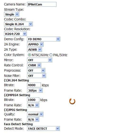

hi all,
I have an Appro dm365IPNC-MT5 Camera. and I want to test face detection function of this camera. I use kernel and root file system which have been posted by the manufacturer.
I enable this fucntion on web inteface but I cannot see any rectangle which must be drawn around  the detected face in the frame.

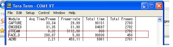

I can see that this fucntion works on terminal.
please tell me how to see the face detection function works visually.
thanks you.
    Which version of IPNC Reference Design release are you using? Can you share the bootup log and the application execution log that gets printed on serial terminal? I dont remember we had any problems with face detection operation, other than the initial few releases. Also, please share the video stream that you are recording from the camera.
    Anshuman
  • hi,
    the version I am using is IPNC_1.5. below is my bootup log

     Module   | Avg Time/Frame | Frame-rate | Total time | Total Frames |
     CAPTURE  |          33.36 |      29.98 |      30056 |          901 |
     ENCODE0  |          30.75 |      32.52 |      27673 |          900 |
     STREAM   |           0.29 |    3422.05 |        263 |          900 |
     FACE.D   |         199.91 |       5.00 |      29986 |          150 |
     AEWB     |           1.52 |     657.41 |       1369 |          900 |
     CAPTURE  |          33.35 |      29.99 |      60094 |         1802 |
     ENCODE0  |          30.72 |      32.55 |      55327 |         1801 |
     STREAM   |           0.29 |    3497.09 |        515 |         1801 |
     FACE.D   |         199.94 |       5.00 |      59981 |          300 |
     AEWB     |           1.45 |     687.40 |       2620 |         1801 |
     CAPTURE  |          33.35 |      29.99 |      90137 |         2703 |
     ENCODE0  |          30.71 |      32.57 |      82968 |         2702 |
     STREAM   |           0.28 |    3522.82 |        767 |         2702 |
     FACE.D   |         199.94 |       5.00 |      90173 |          451 |
     AEWB     |           1.44 |     695.50 |       3885 |         2702 |
     CAPTURE  |          33.35 |      29.99 |     120176 |         3604 |
     ENCODE0  |          30.70 |      32.57 |     110630 |         3603 |
     STREAM   |           0.28 |    3574.40 |       1008 |         3603 |
     FACE.D   |         199.94 |       5.00 |     120165 |          601 |
     AEWB     |           1.43 |     699.07 |       5154 |         3603 |
     CAPTURE  |          33.35 |      29.99 |     150231 |         4505 |
     ENCODE0  |          30.70 |      32.57 |     138282 |         4504 |
     STREAM   |           0.28 |    3580.29 |       1258 |         4504 |
     FACE.D   |         199.95 |       5.00 |     150165 |          751 |
     AEWB     |           1.43 |     701.45 |       6421 |         4504 |
    I uploaded a recorded video at this link:
    http://www.mediafire.com/download.php?z4ynhqtmyjl
    I thinks the face detection works but I don't know where to see it visually.
    thanks you.
