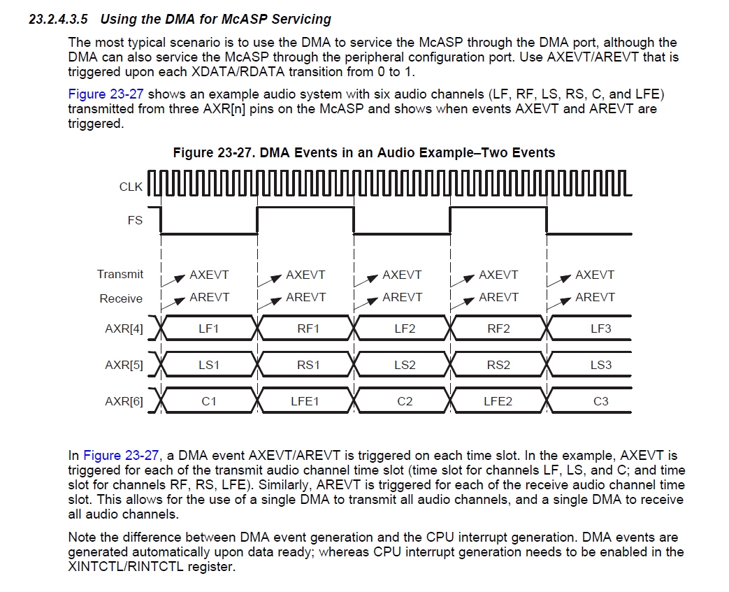

C6748 mcasp multi-channels
Other Parts Discussed in Thread: OMAPL138
How to implement functionality in this picture?
See appendix for my code.  I encountered problem is AXRs no output.

	// ���ô�����������11ͨ������
	McASPSerializerTxSet(SOC_MCASP_0_CTRL_REGS, MCASP_XSER_TX|MCASP_XSER_TX2|MCASP_XSER_TX3|MCASP_XSER_TX4);
	// ��ʼ�� McASP ���ţ������������������
	McASPPinMcASPSet(SOC_MCASP_0_CTRL_REGS, 0xFFFFFFFF);
	McASPPinDirOutputSet(SOC_MCASP_0_CTRL_REGS,  MCASP_PIN_AXR(MCASP_XSER_TX)| MCASP_PIN_AXR(MCASP_XSER_TX2) |MCASP_PIN_AXR(MCASP_XSER_TX3)| MCASP_PIN_AXR(MCASP_XSER_TX4) | MCASP_PIN_AFSX | MCASP_PIN_ACLKX);
	//McASPPinDirInputSet(SOC_MCASP_0_CTRL_REGS, MCASP_PIN_AHCLKX );
/*              ��ʼ�� McASP Ϊ I2S ģʽ	                                */
void McASPI2SConfigure(unsigned char transmitMode, unsigned char wordSize,
		unsigned char slotSize, unsigned int slotNum, unsigned char modeDMA)
	// ʹ�� McASP ģ�� PSC
	PSCModuleControl(SOC_PSC_1_REGS, HW_PSC_MCASP0, PSC_POWERDOMAIN_ALWAYS_ON,
			 PSC_MDCTL_NEXT_ENABLE);
	if(transmitMode & MCASP_TX_MODE)
		McASPI2STxConfigure(wordSize, slotSize, slotNum,  modeDMA);
	if(transmitMode & MCASP_RX_MODE)
		McASPI2SRxConfigure(wordSize, slotSize, slotNum,  modeDMA);
/*              ��ʼ�� McASP �ж�			                                */
void McASPIntSetup(unsigned int cpuINT, void (*userISR)(void))
	// ��ʼ���ж�
	IntRegister(cpuINT, userISR);
	IntEventMap(cpuINT, SYS_INT_MCASP0_INT);
	IntEnable(cpuINT);
/*              ��� McASP ���ͺͽ���			                            */
void I2SDataTxRxActivate(unsigned char transmitMode)
		// ���ʹ���ⲿʱ��
		McASPTxClkStart(SOC_MCASP_0_CTRL_REGS, MCASP_TX_CLK_INTERNAL);
		McASPTxSerActivate(SOC_MCASP_0_CTRL_REGS);
		// ʹ��״̬��
		McASPTxEnable(SOC_MCASP_0_CTRL_REGS);
		// ��������0
//		McASPTxBufWrite(SOC_MCASP_0_CTRL_REGS, MCASP_XSER_TX, 0);
		// ���ʹ���ⲿʱ��
		McASPRxClkStart(SOC_MCASP_0_CTRL_REGS, MCASP_TX_CLK_INTERNAL);
		McASPRxSerActivate(SOC_MCASP_0_CTRL_REGS);
		// ʹ��״̬��
		McASPRxEnable(SOC_MCASP_0_CTRL_REGS);
