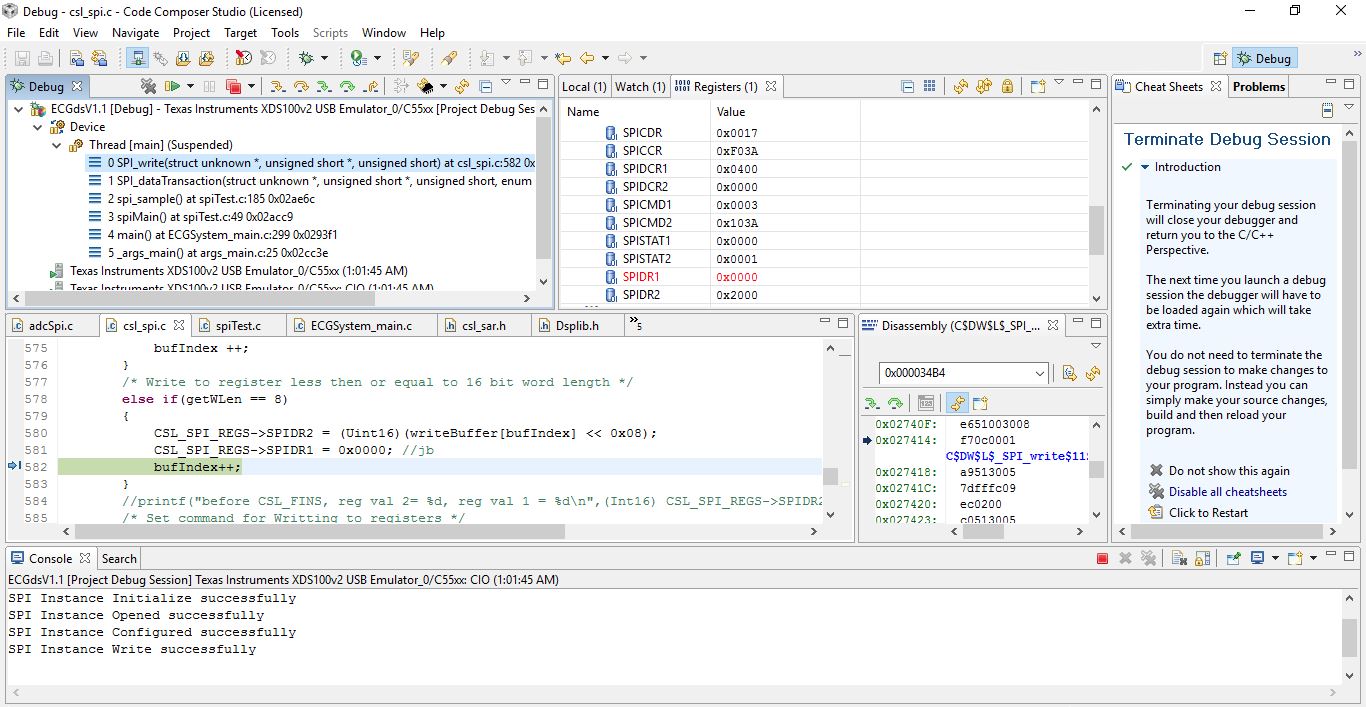

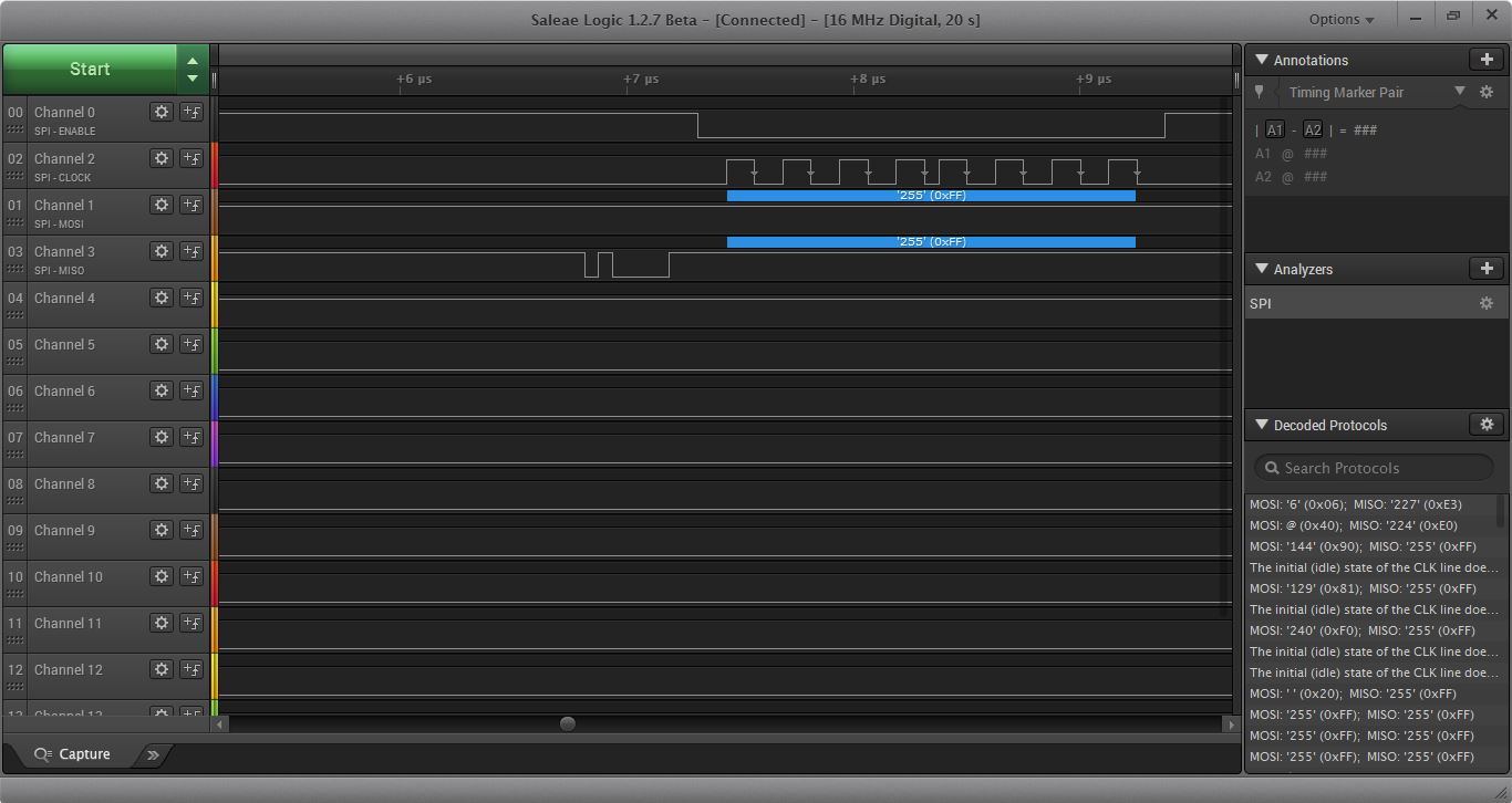

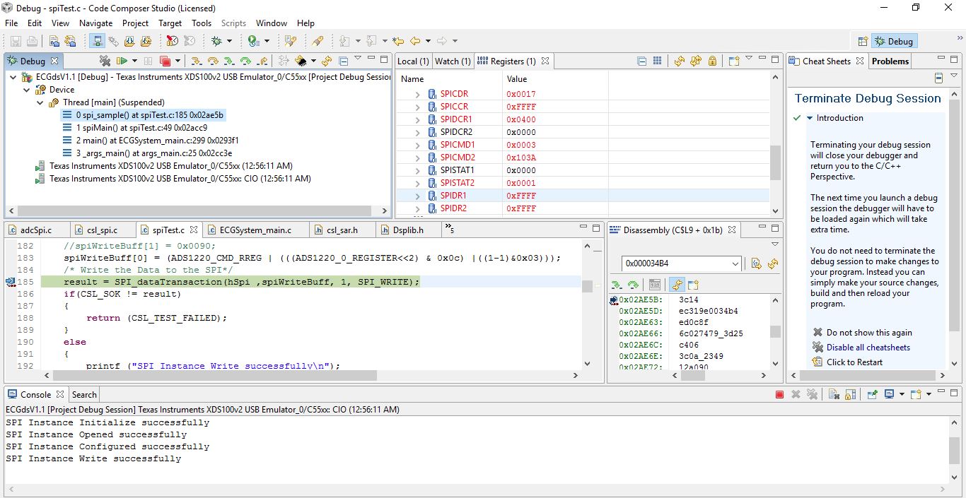

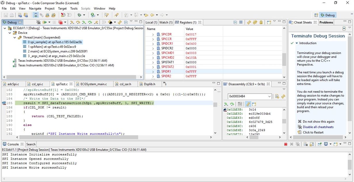

Help Needed Reading Spi Buffer C5535
I am using the ADS1220 with the TMS320C5535 ezDSP and right now I am having trouble reading the data back via spi. We are using a logic analyzer to confirm the two devices are communicating via SPI but it seems that no matter what I keep reading 255(FFh) after sending the start command, 08h. I'm almost positive I am writing to the SPI tx buffer correctly because I see the different config values that I've set on the MOSI channel on the logic analyzer. Could someone maybe point me in the right direction and let me know what I might be overlooking. Below is the code I am using to setup and test the adc and SPI comms which is just me trying to adapt and implement the pseudo code example in the ADS1220's documentation. Additionally, I've attached some screenshots of what I am seeing on the logic analyzer. Hopefully that helps as well.
RECOMMENDED  PSEUDO CODE :
Delay to allow power supplies to settle and power-up reset to complete; minimum of 50 μs;
Configure the SPI interface of the microcontroller to SPI mode 1 (CPOL = 0, CPHA = 1);
If the CS pin is not tied low permanently, configure the microcontroller GPIO connected to CS as an output;
Configure the microcontroller GPIO connected to the DRDY pin as a falling edge triggered interrupt input;
Set CS to the device low;
Delay for a minimum of td(CSSC);
Send the RESET command (06h) to make sure the device is properly reset after power-up;
Delay for a minimum of 50 μs + 32 · t(CLK);
Write the respective register configuration with the WREG command (43h, 08h, 04h, 10h, and 00h);
As an optional sanity check, read back all configuration registers with the RREG command (23h);
Send the START/SYNC command (08h) to start converting in continuous conversion mode;
Delay for a minimum of td(SCCS);
Clear CS to high (resets the serial interface);
Loop
Wait for DRDY to transition low;
Take CS low;
Send 24 SCLK rising edges to read out conversion data on DOUT/DRDY;
Delay for for a minimum of td(SCCS);
Clear CS to high;
Take CS low;
Send the POWERDOWN command (02h) to stop conversions and put the device in power-down mode;
Clear CS to high;
My code:

Int16 spi_sample(void)
	Int16 			status = CSL_TEST_PASSED;
	Int16 			result;
	Int16 spiCount = 0;
	Int16 delay;
	CSL_SpiHandle	hSpi;
	SPI_Config		hwConfig;
	Uint32 			data;
	volatile Uint32	looper;
	result = SPI_init();
	if(CSL_SOK != result)
		status = CSL_TEST_FAILED;
		return (status);
	else
		printf ("SPI Instance Initialize successfully\n");
  result = SYS_setEBSR(CSL_EBSR_FIELD_PPMODE, CSL_EBSR_PPMODE_1);
       if (CSL_SOK != result)
       printf("SYS_setEBSR failed\n");
       return (result);
	//see if this is the equivalent of asserting the CS
	hSpi = SPI_open(SPI_CS_NUM_1, SPI_POLLING_MODE);
	if(NULL == hSpi)
		return (CSL_TEST_FAILED);
	else
		printf ("SPI Instance Opened successfully\n");
	/** Set the hardware configuration 							*/
	hwConfig.spiClkDiv	= SPI_CLK_DIV;
	hwConfig.wLen		= SPI_WORD_LENGTH_8;
	hwConfig.frLen		= SPI_FRAME_LENGTH;
	hwConfig.wcEnable	= SPI_WORD_IRQ_DISABLE;
	hwConfig.fcEnable	= SPI_FRAME_IRQ_DISABLE;
	hwConfig.csNum		= SPI_CS_NUM_1;
	hwConfig.dataDelay	= SPI_DATA_DLY_0;
	hwConfig.csPol		= SPI_CSP_ACTIVE_LOW;
	hwConfig.clkPol		= SPI_CLKP_LOW_AT_IDLE;
	hwConfig.clkPh		= SPI_CLK_PH_RISE_EDGE; //was falling edge
	result = SPI_config(hSpi, &hwConfig);
	else
		printf ("SPI Instance Configured successfully\n");
//jb recommended to disable loopback mode and enable EBSR
	/*Enable the Internal Loopback mode*/
//#if (defined(CHIP_C5517))
//    CSL_FINST(CSL_SPI_REGS->SPIDCRU,SPI_SPIDCRU_LPBK,ENABLE);
//#else
//#if (defined(CHIP_C5505_C5515) || defined(CHIP_C5504_C5514))
//    CSL_FINST(CSL_SPI_REGS->SPIDC2,SPI_SPIDC2_LPBK,ENABLE);
//#endif
//#endif
	for(looper = 0; looper < CSL_SPI_BUF_LEN; )
		spiWriteBuff[looper] = 0;
		if(CSL_SPI_BUF_LEN>1){
		spiWriteBuff[(looper + 1)] = 0;
		spiReadBuff[(looper + 1)] = 0;
		spiReadBuff[looper] = 0;
		//spiReadBuff[(looper + 1)] = 0;
		looper += 2;
	//send reset command (0x06h)
 	spiWriteBuff[0] = 0x0006;
	/* Write the Data to the SPI*/
	result = SPI_dataTransaction(hSpi ,spiWriteBuff, 1, SPI_WRITE);
	else
		printf ("SPI Instance Write successfully\n");
	EZDSP5535_waitusec(10000);
	//send write reg command
	spiWriteBuff[0] = (ADS1220_CMD_WREG | (((ADS1220_0_REGISTER<<2) & 0x0c) |((1-1)&0x03)));//0x0040; //write to register 0, 1byte(8bits), (0100 0000)
	else
	//config first buffer
//	spiWriteBuff[7] = 1; //config the input to be AIN1 and negative reference to be tied to ground
//	spiWriteBuff[6] = 0;
//	spiWriteBuff[5] = 0;
//	spiWriteBuff[4] = 1;
//	spiWriteBuff[3] = 0;//config the gain to be one
//	spiWriteBuff[2] = 0;
//	spiWriteBuff[1] = 0;
//	spiWriteBuff[0] = 1;//disable PGA
 	spiWriteBuff[0] = 0x0090;
//	for(looper = 0; looper < 8; )
//		spiWriteBuff[looper] = 0x0011;
//		spiWriteBuff[(looper + 1)] = 0x00AB;
//		spiReadBuff[looper] = 0x0000;
//		spiReadBuff[(looper + 1)] = 0x00CD;
//		looper += 2;
	else
	//send write for 2nd buffer
	spiWriteBuff[0] = (ADS1220_CMD_WREG | (((ADS1220_1_REGISTER<<2) & 0x0c) |((1-1)&0x03)));//0x0044; //write to register 1, 1byte(8bits), (0100 0100)
	else
	//config second buffer
//	spiWriteBuff[7] = 1; //config the sampling frequency to 330 sps duty cycle
//	spiWriteBuff[4] = 0; //set to normal cycle sampling mode
//	spiWriteBuff[2] = 1; //set for continuous conversion mode
//	spiWriteBuff[1] = 0; //disable temp converter
//	spiWriteBuff[0] = 0; //disable burnout current sensor
 	spiWriteBuff[0] = 0x0081;
	else
	spiWriteBuff[0] = (ADS1220_CMD_WREG | (((ADS1220_2_REGISTER<<2) & 0x0c) |((1-1)&0x03)));//0x0048; //write to register 0, 1byte(8bits), (0100 1000)
	else
	//config third buffer
//	spiWriteBuff[7] = 1; //config analog supply as voltage reference
//	spiWriteBuff[6] = 1;
//	spiWriteBuff[5] = 1; //config for 60Hz rejection filtering
//	spiWriteBuff[3] = 0;//config default
//	spiWriteBuff[2] = 0;//config for default
 	spiWriteBuff[0] = 0x00F0;
	else
	spiWriteBuff[0] = (ADS1220_CMD_WREG | (((ADS1220_3_REGISTER<<2) & 0x0c) |((1-1)&0x03)));//0x004C; //write to register 0, 1byte(8bits), (0100 1100)
	else
	//config fourth buffer
//	spiWriteBuff[7] = 0; //config default
//	spiWriteBuff[4] = 0;//default
//	spiWriteBuff[1] = 1;//set DREADY/DOUT when data is ready
//	spiWriteBuff[0] = 0;//reserved
 	spiWriteBuff[0] = 0x0001;
	else

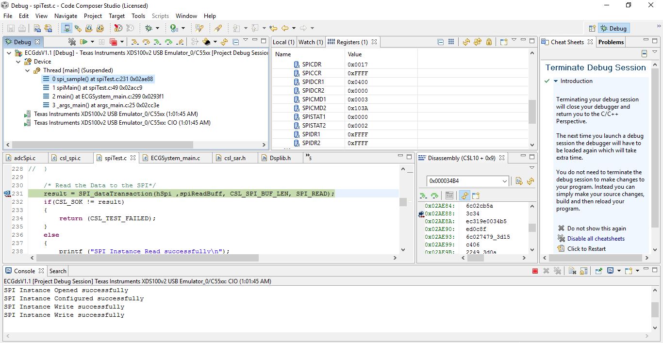

	//optional sanity check to read back all registers with RREG cmd(0x23h)
	spiWriteBuff[0] = (ADS1220_CMD_RREG | (((ADS1220_0_REGISTER<<2) & 0x0c) |((1-1)&0x03)));//0x0023;
//	/* Write the Data to the SPI*/
	else

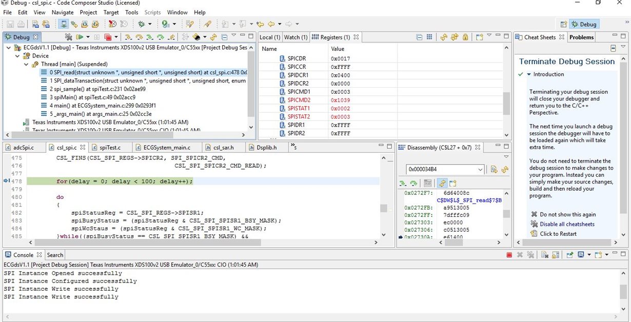

	result = SPI_dataTransaction(hSpi ,spiReadBuff, CSL_SPI_BUF_LEN, SPI_READ);
	else
		printf ("SPI Instance Read successfully\n");
	spiWriteBuff[0] = (ADS1220_CMD_RREG | (((ADS1220_1_REGISTER<<2) & 0x0c) |((1-1)&0x03)));//0x0023;

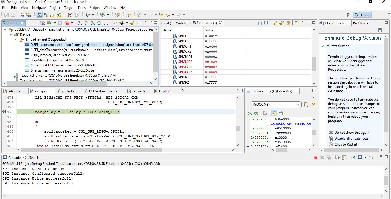

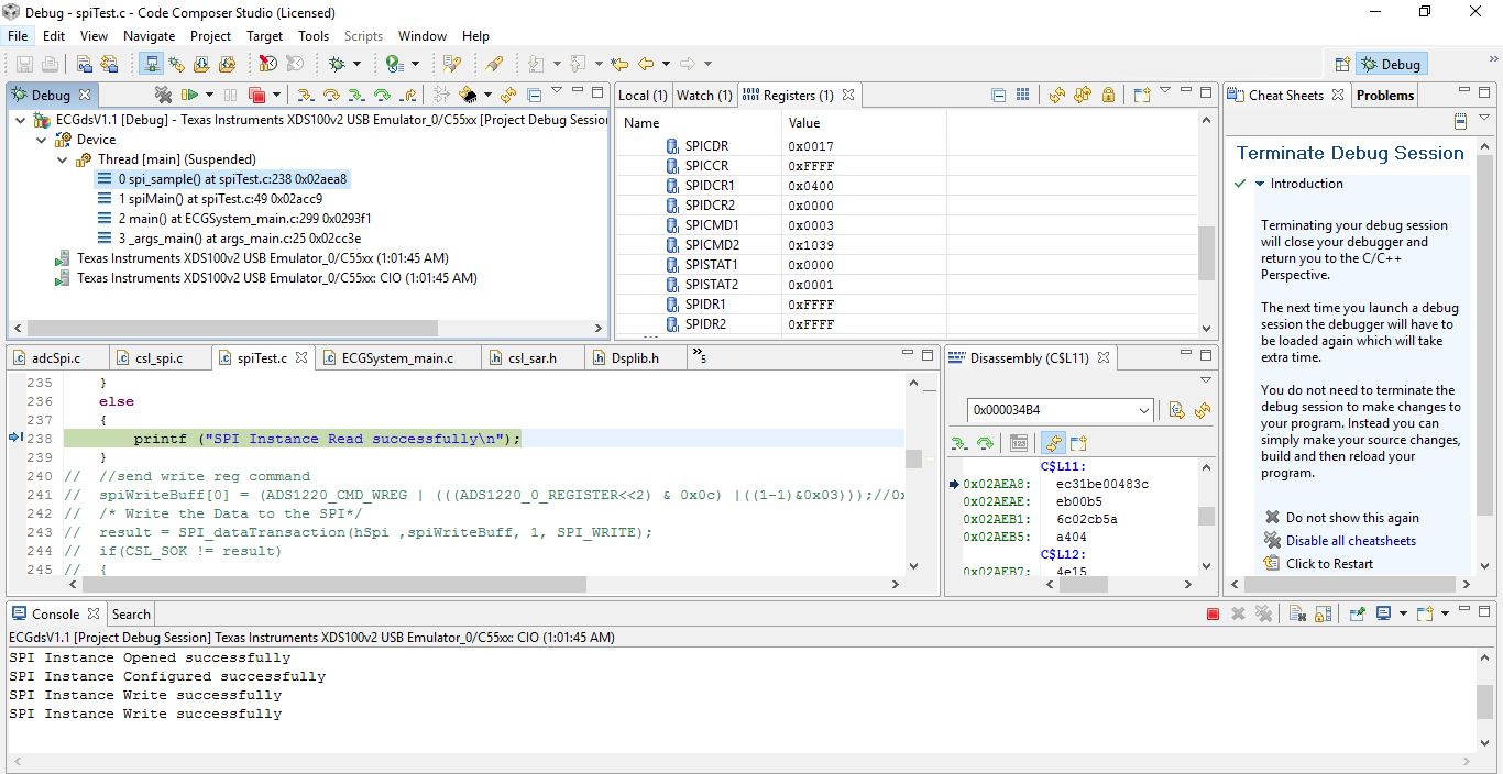

UPDATE: SPI REGISTER VALUES
  • Hi Ulbert,
     Will get back to you.
    Meanwhile can share the SPI registers content as you read from CCS register window.
     Vasanth
  • Hey Vasanth,
    Thanks for getting back to me. I'm going to post the screenshots in my original post because I can't post them in the reply for some reason. They show the register's new values whenever a SPI register changes. For this test I did 2 writes and 1 read, but only the last two operations are shown in the screenshots. The first write was a reset command to reset the adc and its registers, the second command was a Read register command that was written to the spi tx buffer, at least i think it was. Afterwards I should be able to read back the default register configuration from the first configuration register which is why I next use the spiDataTransaction function for a read functionality.

    One last thing too. I additionally consulted the precision data converters forum and they suggested holding CS low for entire transactions. "For example, for reading out the data, you want to send /CS low, send the RDATA command (10h), send in 24 SCLKs to read back the data, and then send /CS high again. " I'm not to sure how to do this with the CS on the dsp and sending variable clock cycles such as 24. Any attempts I have made to do so haven't seemed to be working so maybe you can point out what I'm overlooking for those actions. Thanks for trying to help out and I look forward to any advice you may have.
    Sincerely,
    Ulbert
  • HI Ulbert,
    If I understand you correctly the commands are being sent out correctly, but your read operation is failing and you always read FF is this correct ?
    If you are observing all the commands sent out correctly, then you might need to check on ADS side. But before that could you confirm on above, if its true.
     Vasanth
