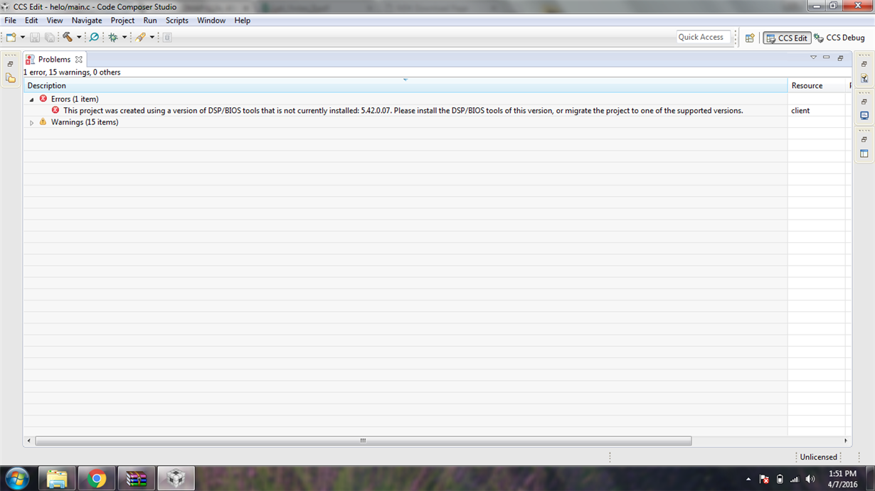

    As shankari sir ,told i imported the client project by installing NDK.....but it was showing DSP/BIOS not installed....what to do with this...see the attachment...
    thank you

  • then why am getting error like that(shown in attachment above)...?
    any suggestions..?
    thank you

  • As shankari sir ,told i imported the client project by installing NDK.....but it was showing DSP/BIOS not installed....what to do with this...see the attachment...
    Seems to be you have to install the DSB/BIOS package (older version of SYSBIOS).
    Have you installed the packages like below.
    C:\ti\bios_5_41_13_42
    C:\ti\bios_5_42_01_09
    That NDK examples is old and it built with older BIOS version called DSP/BIOS.
    Install the DSP/BIOO and add it into the client project, try to rebuild.
    Please let me know if any.
  • yes i have "bios_5_42_00_07"....i am trying in windows 7 with ccs version 6.....is it ok for ethernet example....? is it mandatory to work with linux only..?i have installed NDK things....but i got error as shown in earlier attachments...please overcome with this...
    thank you

  • Sorry, I've requested complete project, so that I can build it and attach it for you.
    I think, already you have asked this NDK question for OMAPL137, I request you to go through those links which I shared to you already.
    I hope, you can get the example from that legacy download link.
    We have ready made NDK example for OMAPL138 and port it to OMAPL137. ( I have seen some of the customers ported to OMAPL137 and using it)
  • Hi Titus,
    My complete project,client for omapl137 is attached...i tried what u said last in last conversation but i am not getting it properly.
    please go through it.
    thank youclients.rar
  • Please follow the suggestion in the below post and port into C6747.
    e2e.ti.com/.../1832623
    C6747 and C6748 is almost same, refer to both data sheets for the difference.
  • Hi Titus,
    How can we modify....where should we modify....?
    when i load .out file of client ,it shows "EMAC OPEN RETURNED ERROR"
    HOW TO OVER COME WITH THIS...
    thank you
  • Please don't reply or follow up on this post as its different problem and also you opened new post for this problem.
    Thanks for your understanding.
  • Mohammad,
    I just came across your post. If you're still stuck on this, the answer is you need to download/install DSP/BIOS. You can get that from here:
    software-dl.ti.com/.../index_FDS.html
    Steve
