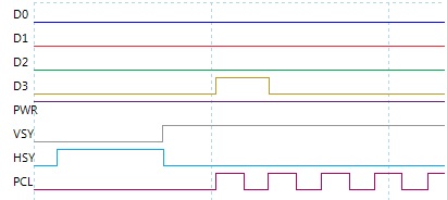

Unfortunatelly, on oscilloscope I see only PCLK, VSYNC, HSYNC without any data for first 32 bits
and in magnification
What shoud I change for see proper view on LCD? What is wrong in configuration?

    So, my test looks like raw managing of am3359 cpu lcd driver in raster mode (without "real" usage of Linux fb driver).
    And with "FFFFFFFF" at the begin of dma memory (begin of fb) I see on osc. "1" on D0 and D1 on 1st clock, so first 2 pixels are enabled.
    But should be "1" on D0..D3 for 8 first clocks (enabled first 32 pixels on LCD).

    Last test shows that for data in dma memory:
    - pushed 1p.bin: "enables" 1 pixel (D0 is "1") - but 4th pixel on LCD is enabled.
    - pushed 2p.bin: "enables" 2 pixel (D1 is "1") - but as 3rd pixel on LCD
    - pushed 3p.bin: "enables" 3 pixel (D2 is "1") - but as 2nd pixel on LCD
    - pushed 4p.bin: "enables" 4 pixel (D3 is "1") - but as 1st pixel on LCD
    Data are pushed to fb0 (cat file_name.bin > /dev/fb0) as binary files created with hex editor (files attached).
    bin.zip
    All pixels were enabled for line 2, but on oscilloscope it was for 1st clock after VSYNC up (attached picture for 4p.bin - 4p.jpg)
    Based on palette configuration - am3359 should push data as described in TRM (spruh73m.pdf) Fig.13-13 in 4-bit output mode.
    But test shows that am3359 is not in 1bpp monochrome mode (....)

    With 0xffffffff inside fb, on oscilloscope I see only "1" on 2 lines for first clock (only 2 pixels on LCD are visible). But I should see 32 pixels !!!
    Of course "1" on D3 -> 1st pixel enabled, "1" on "D2" -> 2nd pixel and so on (based on LCD manual). Its OK.

  • Rafal BARANSKI said:
    0x28 : 0x00280003
    RASTER_CTRL[21:20] PALMODE is programmed to a value of 2, which means "data only" and "no palette lookup".  It looks like the driver (drivers/video/fbdev/omap/lcdc.c) has code related to load_palette().  Have you verified that the palette is being loaded (i.e. that the code is executing and has the proper addresses programmed)?
    I've spent quite a bit of time looking through all your registers and that's the only thing I have come up with that might remotely explain what you're seeing.  In particular, if the palette was not loaded properly then there would not be any palette lookup happening, and that would explain why you're not seeing one bit turned into many like you're expecting.
    Can you add a bit of instrumentation to dump out the registers before after you load the palette?  I think it's worth exploring that a little deeper.
  • Good news. We were able to get this working with the help of some of my colleagues. Key findings were:
    1. Continuous allocated memory for palette and data (32B+9600B) for 320x240 mono lcd (1bpp)
    2. dma_start=”start of memory”, dma_end=”end of memory”
    3. support for PALETTE_AND_DATA mode in ‘lcd_blit’ function (da8xx-fb.c)
    4. only PALETTE_AND_DATA mode used (during load palette and also data)
    5. fixed values for fb e.g. screen_base, fix.smem_start etc. as: dma_start+32
    Thanks for your patience in getting to resolution!
