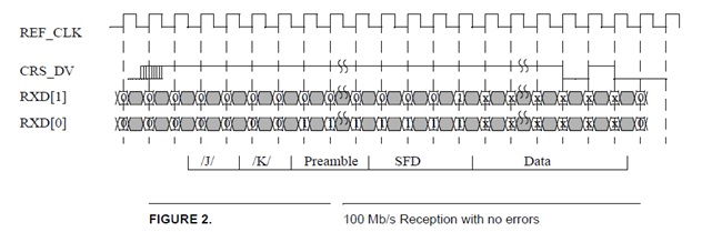

           Port 2 has a problem. TX packets received on the interface chip KSZ8041 RMII 2 from CPSW, are sent to the network and registered Wireschark program. RX Packets are KSZ8041 chip from the network and transfer to the port 2 CPSW registered in registers «RX Align / Code Error» «RX CRC Error» and no packet is not registered in the «Good Rx Frames» in CPSW_STATS_REGISTERS. Accordingly, the packets are sent from the port 2 to CPSW host port 0 and interrupt CPDMA never registered.
I took the oscillograms on RMII 2. They are listed below.
Figure 1. Signals are TXEN, TXDO, TXD1.
Figure 2. Signals are CRS_DV, RXDO, RXD1
Figure 3. Signals are CRS_DV, RXDO, RXD1. The whole delay.
I have read the specification «RMII Specification» and saw that CRS_DV signal can be removed and approved back:
Would you be so kind to answer my questions below, please.
Why there is a delay of 500 ns (Figure 2) at the beginning of the package? It is associated with setting KSZ8041 or RMII or CPSW?
The topology of the board may affect it? Figure topology enclose:
