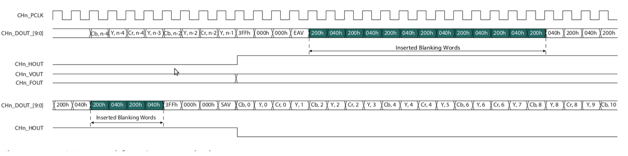

We are studying the HD-SDI receiver GV7704 interface with DM8168 VIP port.
The following is video output mode of GV7704
10-bit BT.1120 embedded sync:
10-bit BT.656 embedded sync:
(1) Per DM8168 datasheet, VIP could not support 8-bit BT.1120 embedded sync mode. Is it possible support 8-bit BT.656 embedded sync from GV7704?
(2) Per GV7704 datasheet, In BT.656 mode, the GV7704 will re-format the parallel video output to conform with BT.656 embedded TRS. The device will replace all data words from the second TRS, line number and line CRC with blanking values, as shown in figure. Is it OK for VIP capture?
(3) BTW, could we use the 8-bit BT.1120 discrete mode for VIP capture? it seems ok. is it right?
