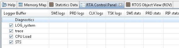

I am trying to get a basic example using the STS module working in Code Composer Studio version 5.5 on a LogicPD OMAP-L138 EVM board.
As a starting point I used the DSP/BIOS "hello example" which uses the LOG module. This example works - it prints out the message.
I then added the header files for STS and CLK module. In a next step I added calls to both STS_set and STS_delta functions.
What I want to benchmark/profile in this basic example is the call of LOG_printf and stdio printf functions (so I added stdio header file also).

I also double-clicked the hello.tcf DSP/BIOS configuration file and "inserted STS" twice under Instrumentation -> STS:
Both with unit type high res. and host operation "A * x". The names equal the names in the .c file.
This adds the following lines to the .tcf files:
bios.STS.create("stsPrintf");
bios.STS.create("stsLogprintf");
bios.STS.instance("stsPrintf").unitType = "High resolution time based";
bios.STS.instance("stsLogprintf").unitType = "High resolution time based";
And the hellocfg.h file also is expanded by:
extern far STS_Obj stsPrintf;
extern far STS_Obj stsLogprintf;
The project still compiles and can be loaded and run on the target DSP (C6748). How can I access the data?
I read in the CCS Tutorial (not explicitly for CCSv5, rather older versions) to open "RTA Control Panel" and "Statistics Data" view.
Both views can be found under Tools -> RTOS Analyzer -> RTA (Legacy). Not to sure if I am right here as legacy might refer to older CCS versions?
"RTA Control Panel" looks like this:
The "Statistics Data" is always empty. Which steps am I missing and/or am I using the wrong view to query the data?
I had a look in the "RTOS Object View (ROV)" before where I could also see the LOG messages, but probably STS is not a "viewable" module.
Edit 1: Maybe relevant: "Enable Real Time Analysis" is set to "True" in the Global System Settings (in the Config Tool).
Edit 2: I cannot find the RTA Control settings Panel which is referenced in some documents, i.e. processors.wiki.ti.com/.../RTA_Control_Panel.JPG
Edit 3: Do I need to create a task and call STS_... from there? If yes, is there a way to avoid it? [Refering to https://e2e.ti.com/support/embedded/tirtos/f/355/p/48450/187912#187912 ]
Any hints will be very much appreciated. Thanks!

  • Can you let us know what version of BIOS you are using?
    STS is a BIOS 5 module, there is a legacy API support module in SYS/BIOS 6 for it but there is no SYS/BIOS 6 equivalent module that offers the same functionality. This might be what you are experiencing if you are using SYS/BIOS 6, and it is not clear to me what these legacy APIs are actually doing, but looks like it is not producing any actual statistics that is viewable via legacy RTA Control UI in CCS.

  • Dear Murat,
    thanks for your reply. There are two folders under C:\ti\ that have a "bios" in their name:
    \bios_5_42_01_09 -> "DSP/BIOS 5.42.01.09 is a GA release based on DSP/BIOS 5.42.00.07. " (from the release notes)
    \bios_6_35_04_50 -> "SYS/BIOS 6.35.04.50 is a GA release of SYS/BIOS 6.35.00."
    IIRC both were installed with the latest release build v5.5.0.00077 (September 2013).
    Edit: the properties dialog of my basic example reads "5.42.1.09" in the DSP/BIOS tool version dropdown list (and is the only selectable value).
    Matthias

  • Hi Matthias,
    I don't think you are missing anything. It is just that STS is *not* supported on SYS/BIOS 6, and the STS API functions for all practical purposes don't do anything useful until (and if) STS gets supported. They might be left as stubs to support migrating legacy content -- my guess.
    Murat
  • Dear Murat,
    thanks for coming back to me. I just wanted to say that my initial problem is related to the execution of DSP/BIOS code on the C6748 DSP of an OMAP-L138 EVM board. I have tried to accomplish the same (get STS info) for an C6748 LCDK now with the same issue - I simply do not get any data displayed (only LOG, no STS). The RTOS version the linker uses is still an "old" one (DSP/BIOS: bios_5_42_01_09, not SYS/BIOS 6.x). Thee CCS is a Version: 5.5.0.00077.
