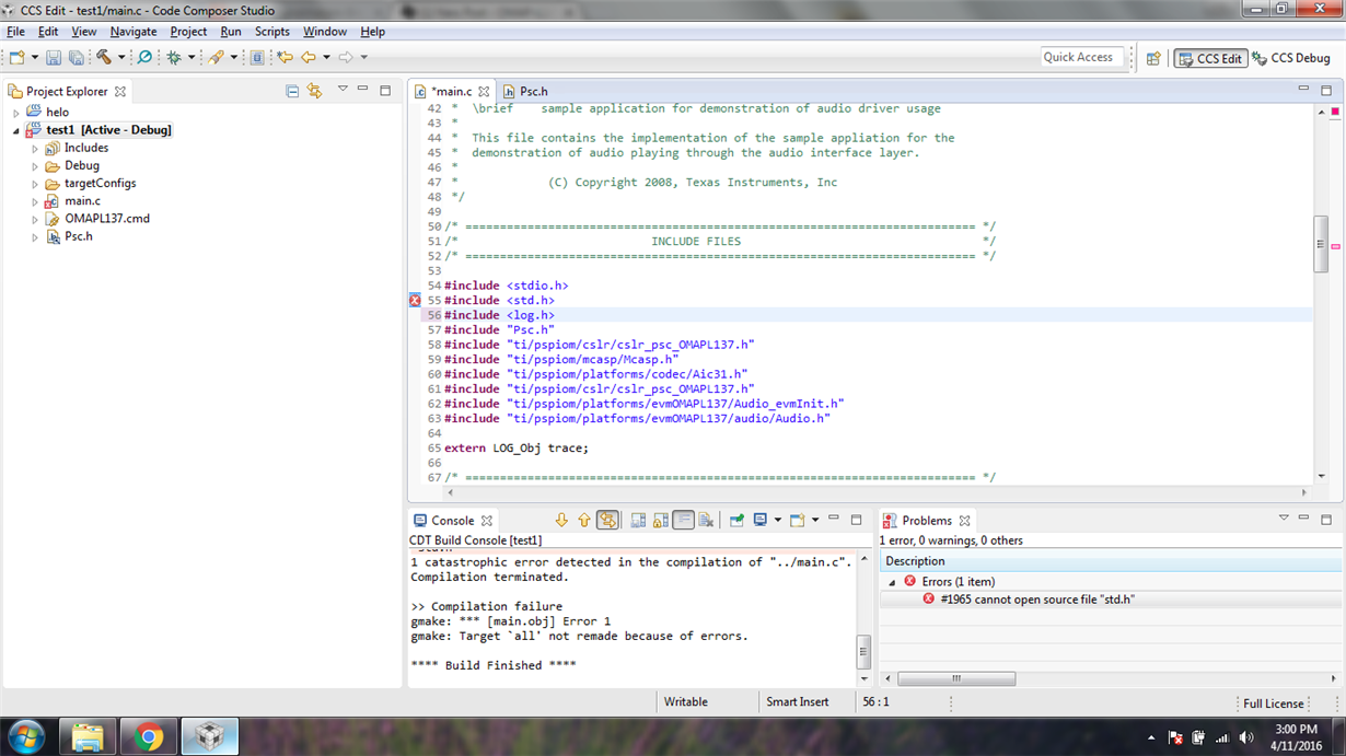

Dear sir,
I am working with audio exapmle given by texas,but i am not getting header file "std.h and log.h"....whre can i find this....In compiler i got stdlib,stdio,....like that but not std.h".

Thanks for your post.
I think, both "std.h" and 'log.h" can be found in the below specified path:
~ti\bios_5_42_01_09\packages\ti\bios\include
~ti\bios_6_35_04_50\packages\ti\bios\include
Please check the above bios directories to locate log.h and std.h
