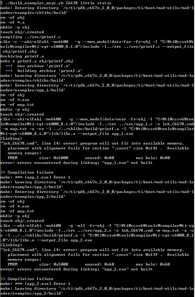

  • I have some problem when i try using msys.
    It's error like following image.
    And i modified 'build_examples_msys.sh' file like following text

    export C_DIR='"C:\ti\ccsv6\tools\compiler\ti-cgt-c6000_8.1.0"'
    export PATH=$PATH:/c/ti/ccs6/tools/compiler/ti-cgt-c6000_8.1.0/bin
    mkdir -p bin/$1/$endian
    #Build for device $1
    make -C shlibs/build clean all DEVICE=$1 ENDIAN=$2 MODE=$libmode
    make -C app_1/build clean all DEVICE=$1 ENDIAN=$2 MODE=$mode
    make -C app_2/build clean all DEVICE=$1 ENDIAN=$2 MODE=$mode
    I don't know why it fails.
