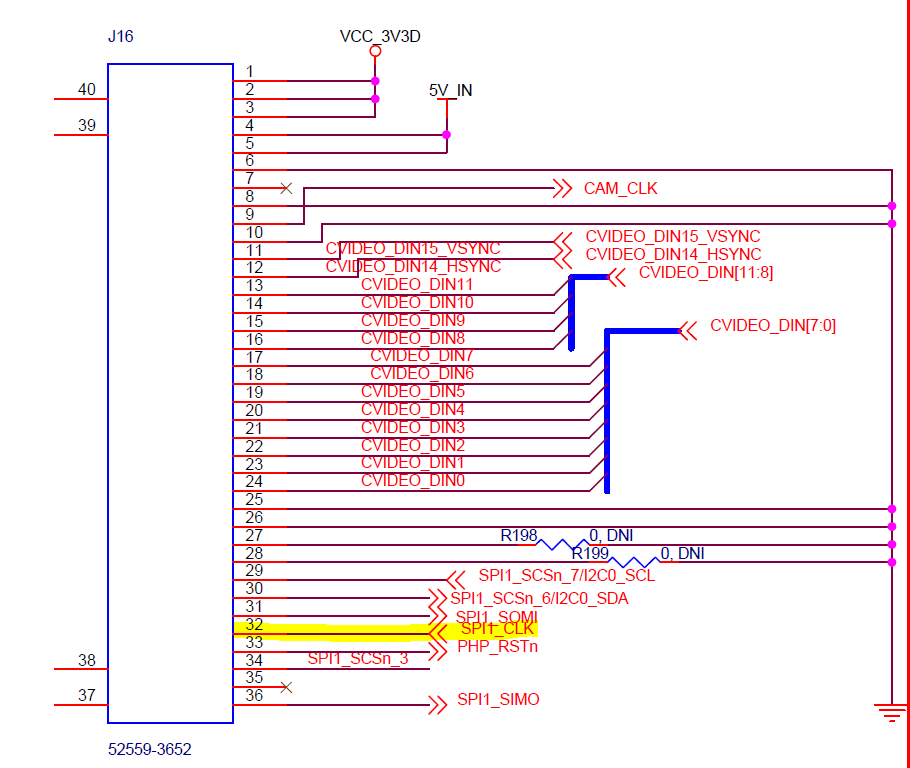

Hi all,
I am trying to configure the SPI1 for use however when I place the line on a probe I cannot see the SPI1's clock signal. I connected the probe to the zif connector's pin 32 output as shown in the picture below. (Highlighted pin is the one currently being probed).
I have set up the SPIGCR1.clkmod register to be 1 (internal clock), and set the SPIPC0.CLKFUN to be 1 (SPI function pin) as well. I know that the SPI1 uses the ASYNC3 clock as its source and by default the ASYNC3 uses the PLL0_SYSCLK2 by default. The GEL file for the C6748 initialises the PLL0 for 300MHz. I have followed the technical reference step by step and I do not know what else is needed or am I missing something. In my understanding, the SPI1 clock should run once I have set the pin to be an SPI function pin. Is there anyone who has experienced this problem?

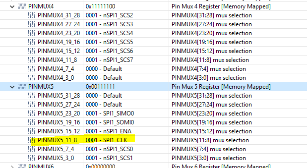

  • Dear Jerome,
    Have you done the PINMUX for SPI1 clock pin ?
    You have to change the PINMUX5 register for SP1_CLK pin.
    PINMUX5_11_8
    Please refer to the OMPL138 TRM guide, SYSCFG module chapter.
  • Hi Titus,
    I have set the PINMUX registers as,
    PINMUX3 = 0x11111111;
    PINMUX4 = 0x11111111;
    PINMUX5 = 0x00111111;
    This is for both SPI1 and SPI0 when I was first testing out the SPI0. However even with only the SPI1 enabled it does not have any conflicts and comes out to be,
    PINMUX4 = 0x11111100;
    I do not understand what is PINMUX5_11_8 though, does that refer to PINMUX 11 and 8 as well?
    Its PINMUX5 register and 8-11 is the bit for SPI_CLK pin.
    Please refer to the OMAPL138/C6748 SYSCFG module.
  • Hi Titus,
    I have done all those and my PINMUX5_11_8 is set correctly. I have attached a picture showing that below.
    I have also checked the PDSTAT0 register for the SPI1 to see if the state has changed and it has.
    I am at my wits end and have no idea what could be wrong except that it might be a hardware issue. I have attached my code below for reference, if you have time can you spot any initialization step that I may have forgotten? Thank you

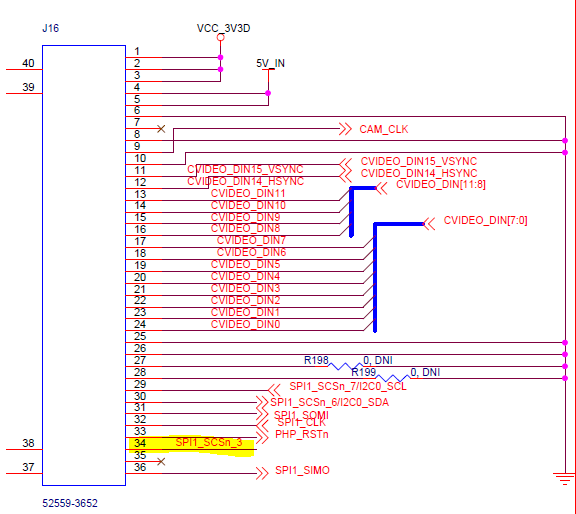

  • I am also unable to toggle SPI1's chip select 3 pin and see a response on pin 34.
    Please try to probe in R208 and R209 (try both ends of resistor)
    You have to short the R208 to get the SPI1_nCS3 pin on J16 connector.
  • Hi Titus,
    Thank you, I am now able to see a response from chip select 3 on the zif. Are you able to see SPI1_clk signal on the zif though? I am only able to see the SPI1_clk signal when I stop the program I am running on the board. I suspect that means that the SPI1_clk signal is effectively being pulled to some state within the board itself rendering SPI1 unusable. Could you confirm this?
    Jerome Lieow
  • Hi Titus,
    The clock of SPI1 can now be seen when I set GPIO2 as an output. Thank you for your help with the hardware config, without it, I would be stuck for a long time.
    Jerome Lieow
