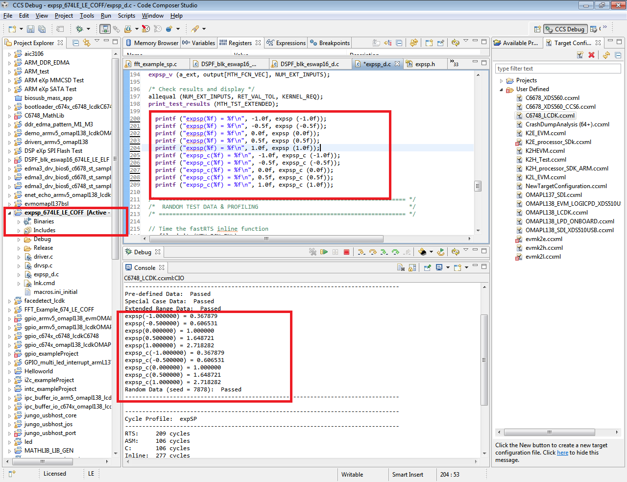

  • HI Bill,
    I have just experimented the functions, "expsp" and the "expsp_c" of mathlib c674x 3_1_1_0 with C674x
    and got the results. Please compare it with yours.
  • To add to Shankari
    I did the same (in parallel with Shankari) and got the same results
    Here is the code and the results:

    And the results are correct

  • William,
    Would you please try out the sample example ( expsp_674LE_LE_COFF ) provided in the Mathlib package and get back to us with the results??
  • Thanks Shankari, Ran. Sorry for the delay, I was out for a while. I will ask the customer to run the above and provide the results.
