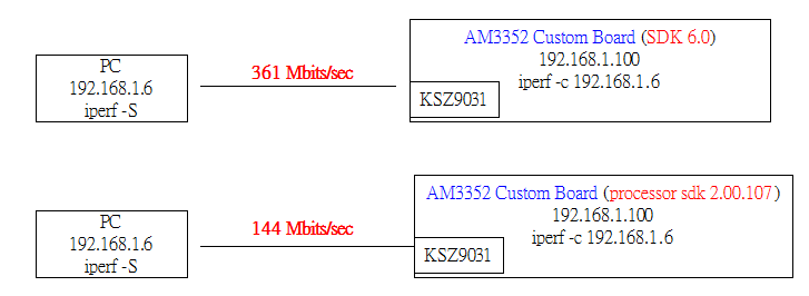

Processor SDK 2.00.107 ethernet speed question
Other Parts Discussed in Thread: AM3352
We use the same AM3352 Custom Board,and Run iperf as following
Why is there such a difference???

  • In Processor SDK 2.00 1.07
    The CPU FREQ is 1G Hz
    root@am335x-evm:/proc# cat /proc/cpuinfo
    processor : 0
    model name : ARMv7 Processor rev 2 (v7l)
    BogoMIPS : 996.14
    Features : half thumb fastmult vfp edsp thumbee neon vfpv3 tls vfpd32
    CPU implementer : 0x41
    CPU architecture: 7
    CPU variant : 0x3
    CPU part : 0xc08
    CPU revision : 2
    Hardware : Generic AM33XX (Flattened Device Tree)
    Revision : 0000
    Serial : 0000000000000000
  • Does TI has any Update about the question??
    The AM335X StarterKit Board have the same problem,too

  • I knew this performance
    AM335X EVM SK in SDK6 is 284M bit/Sec
    AM335X EVM SK in Processor SDK2.0.1.07 is 121M Bit/sec
    Why is there such difference in SDK6 and Processor SDK2.0.107???
