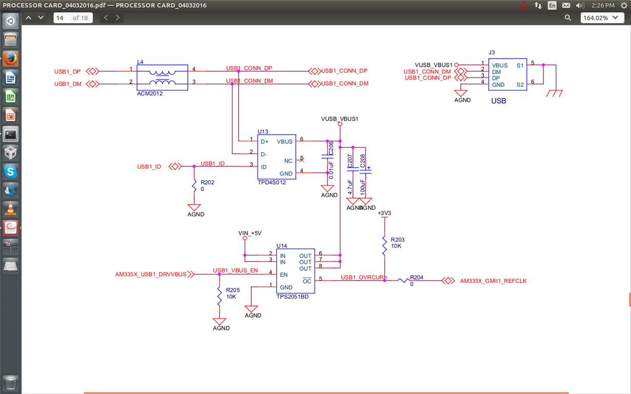

i'm using am3357 custom board when i try to boot the board till kernel it is booting good but it not taking the file-system from sd card..i'm getting below error....

here i measured the voltage value at VUSB_VBUS pin there i'm getting the voltage fluctuations from 0V to 4.4V like every time the voltage is not getting constant....if any body knows plz help me
