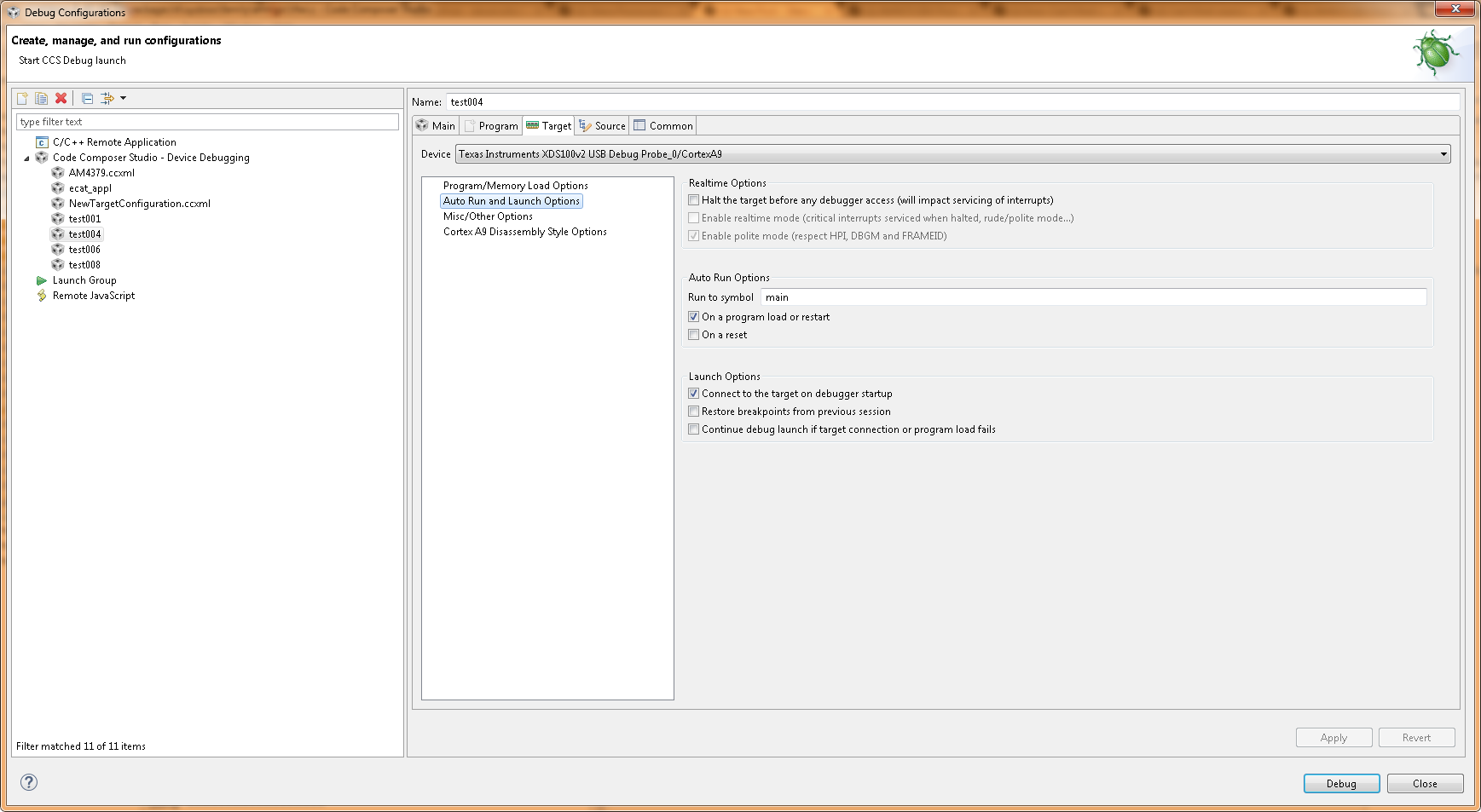

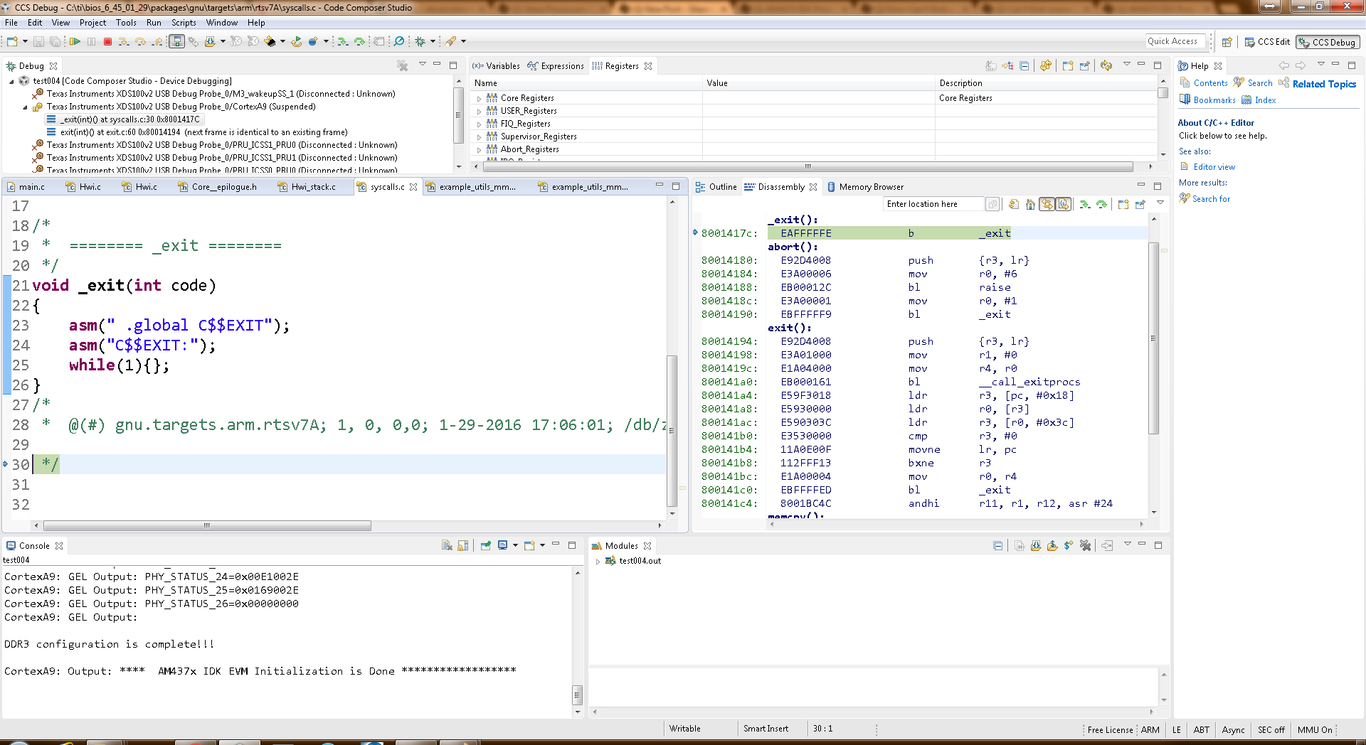

when I attempt to debug the project after "power on" or "physical system restart" every thing works fine ,however if I try to debug the session for second run the debug session will fail .in other words it will call the syscalls.c .
if I step through the program the syscalls.c will be called after execution of following line

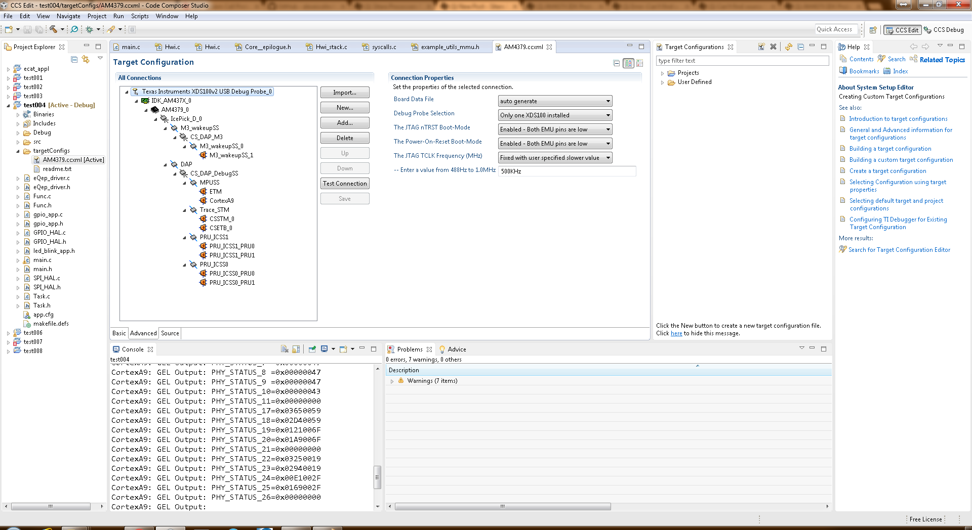

you could check my debug and target configurations on the following images
I have to mention so far this configuration gives me the best result ,in other words if I change any thing I wont be able to start the debug session at all . specially "jtag clock" and "reset the target on debug".

  • Can you explain what you are exactly doing on your "second run".  Most likely, the processor is not in a proper state and a reset would be required.
    James
  • Do you run any example program from Processor SDK 2.0.2.11? What is the application? Why you need to run a program again without reset the ARM core?

    Actually I m debugging exactly same source code no change at all, after the power on or physical system reset the code executed properly.however if I want to debug the exact same code for second run I would encounter syscall.c
    .I have to mention that my other colleague do not encounter this issue at all.

    Taking a look at the video, I see one thing going wrong. After the first loading, to reload you are only "Stopping" the debugger and relaunching it. This doesn't necessarily mean that the board is reset, and as a result when the next load happens the board is in a bad state. If you do a reset(on CCS) before stopping the debugger, it should work fine.
    These are the ideal steps to load a program - processors.wiki.ti.com/.../SYSBIOS_Industrial_SDK_Getting_Started_Guide . In case of reloading, you can skip steps 1,2 and 3
