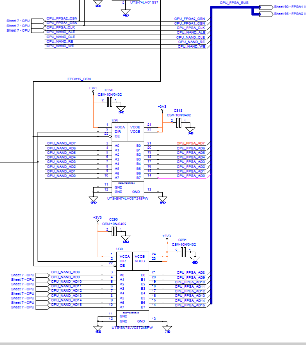

Hi Forum,
I am currently developing a gpmc bus with 4 chip select memory mapped regions.
the nand bus width is 16
cs1 -> is a 8 bit (ad0-ad7)
cs3 ->is a 8 bit (ad0-ad7)
cs5->is a 16bit(ad0-ad15)
cs6->is a 16 bit(ad0-ad15)
below is my device tree settings for nand

when i do a devmem2 from my command line on the 8 bits and the 16 bits the outputs are of these types alternating FF00 whilst i am expecting all 00000 upon reset
root@am437x-evm:~# devmem2 0x03000000 b /dev/mem opened. Memory mapped at address 0xb6f6a000. Read at address 0x03000000 (0xb6f6a000): 0x00 root@am437x-evm:~# devmem2 0x05000000 h /dev/mem opened. Memory mapped at address 0xb6f3e000. Read at address 0x05000000 (0xb6f3e000): 0xFF00 root@am437x-evm:~# devmem2 0x07000000 h /dev/mem opened. Memory mapped at address 0xb6f20000. Read at address 0x07000000 (0xb6f20000): 0xFF00 root@am437x-evm:~# devmem2 0x03000000 h /dev/mem opened. Memory mapped at address 0xb6fc7000. Read at address 0x03000000 (0xb6fc7000): 0xFF00 root@am437x-evm:~# devmem2 0x03000000 w /dev/mem opened. Memory mapped at address 0xb6f76000. Read at address 0x03000000 (0xb6f76000): 0xFF00FF00 root@am437x-evm:~#
I would really appreciate if someone could point out what i might be doing wrong here.
