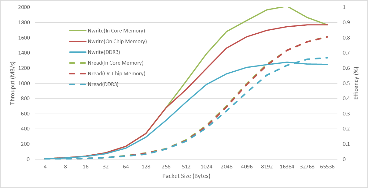

We are doing SRIO throughput test on K2H EVM. The measurement is based on board to board through SRIO switch by using NWrite and NRead packet in 4 lanes 5Gbps mode. The theoretical link rate is 2000 MBytes/s without overhead.(4*5Gbps*0.8/8=2000 MB/s)
The throughput is calculated by: Number_of_Bytes / DSP_clock_MHz / elapsed_cycles. The elapsed cycles are the number of cycles between the point setting LSU and got completion code from LSU_STAT_REG, as showing below.
t_start = _itoll(TSCH, TSCL);
KeyStone_SRIO_LSU_transfer(&lsuTransfer);
uiCompletionCode= KeyStone_SRIO_wait_LSU_completion(0, lsuTransfer.transactionID, lsuTransfer.contextBit);
t_stop = _itoll(TSCH, TSCL);
t_total = (t_stop - t_start) - t_overhead;
In the condition that the source and destination are both L2 SRAM, The NWrite can reach speed higher than 2000MB/s, which is 2015 MB/s.
Can you tell me what is the reason of the measured SRIO speed can be higher than theoretical one?

    Our test is not based on MCSDK. In above figure the "In core memory" means L2 SRAM, "On Chip memory" is MSMC.

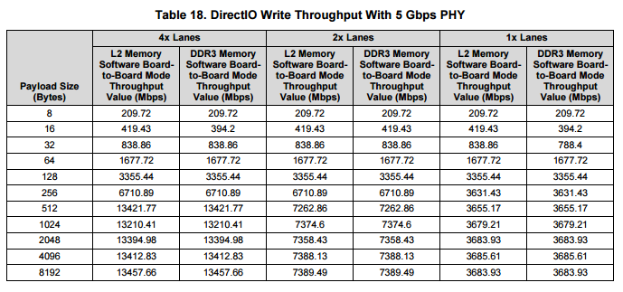

    Oh, it seems like you have update the Throughput document. I have the first version of this document.
    Based on the document you provided, they measure the SRIO throughput by using Doorbell. In the document, it said that:"The total time taken for the packet transfer is calculated by using the doorbell time stamps". I am not quite clear how they use the time stamp in the doorbell measure the throughput.
    Beside the SRIO performance differences between my condition and TI condition, there is a place that my test result is contradict with the document. In the document, the throughput for L2 Memory and DDR3 is almost same (showing in the below figure). In my condition, the place where the memory reside highly influence the performance of SRIO throughput. Usually, the closer the source/destination memory to the core the higher throughput it can achieve.
    The test log for L2 SRAM in our test is showing below. The test log for MSMC and DDR is the same but different performance. You can see their performance in the first post.

    The throughput test results will definitely depend on the method used to measure and number of packets sent.  I believe our throughput numbers show the HW capability because the actual number of packets send are not high. To answer your initial question, you have to remember that for NWRITE packets, the LSU stat register is set with the CC as soon as the last packet of the transfer is moved from the logical layer TX buffers into the physical layer TX buffers.  The packet isn't actually sent out on the pins yet.  So essentially, you are reading a false finish time.  We used doorbell as a mechanism to know that the packet was sent and actually landed in the destination memory before measuring the transmission time.  This is done by measuring the time it takes to write the LSU for doorbell and receive the doorbell response, we save this time measurement, then when we do the data transfers, we end the test by sending a doorbell and when we get the doorbell response we mark the total time it takes and subtract the time it took for a single doobell.
