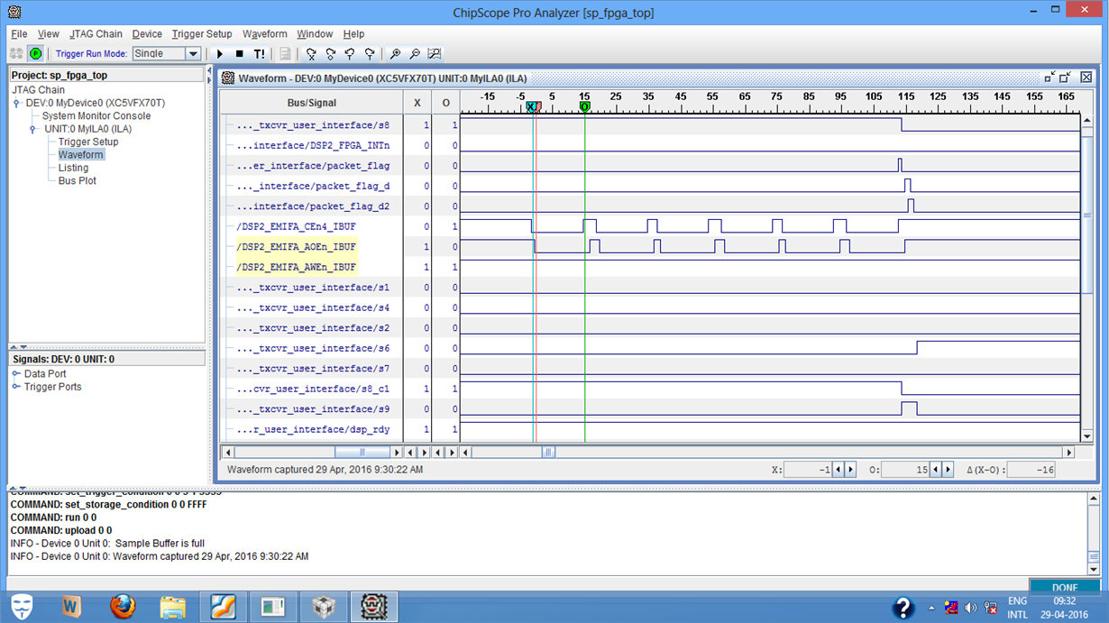

hi all,
i have configured emif in synch mode and i am transferring data from fpga fifo to c6455 dsp thru emif.
i have used edma to read that data.
i have given in edma function to read 768 bytes of data(which is 96 no of 64 bit words). what i observed is that there is an idle time(ce high) of 4 emif clock cycles for every 16 emif reads. how can i reduce it to 0? pls find the attached figure for reference.
one more observation is, between 2 edma reads there is an idle time(ce high) of 400 emif clock cycles.how can i reduce it to as low as possible?
in my code between successive edma reads there is some code which has an addition and receiving interrupt. The reason behind the ce low for huge time ..is it beacuse of this intermitent logic or the edma function is taking this much time for initiating next read or do i have to change any register value?
pls find the attached figure for refernce.
the ce cnfg register value is EMIFA_CE4CFG = 0x8000010B;
thanks in advance
vaishnavi.

  • Can you please tell me the value of "EMIFA.SDCR" register ?
  • does EMIFA.SDCR register exist in 6455 dsp? because i didnt find it in the emif datasheet of this dsp(spru 266e).
    i have found EMIFA.SDCTL register.
    regards,
    vaishnavi.
  • Vaishnavi,
    SDCR is the wrong register name, CEnCFG is correct. You have supplied this value in your original post.
    SPRU266e is the wrong EMIF User Guide. Please go to the TMS320C6455 Product Folder and find the correct EMIF User Guide. There is only one datasheet for the device, SPRS276, which you should also have a copy of.
    To possibly help with the stall after 16 reads, you may want to look for a DBS (Default Burst Size) parameter, if it can be adjusted on the C6455. Or there may just be a fact of the synchronous interface that it will do the writes in bursts of 16 beats at a time.
    To help with the 400 cycles delay, you need to reduce the time required to configure the PARAM for the next DMA operation and to then trigger the next operation. Of course, the compiler optimization settings will be one part of that equation. Further optimization will mean greatly reducing the amount of work done in the edma write function call; there is no need to go through the entire function each time, and going through the entire function will take a lot of time.
    What are you trying to do with the board and the DSP and the FPGA in your actual application? Your code is simply test code trying to evaluate the operations, so you have numbers that say how fast it works now - is that adequate for your application?
    RandyP
