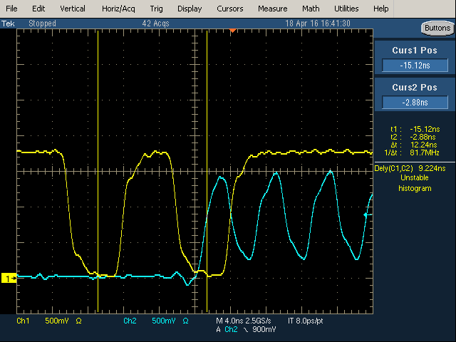

  • The following picture is showing Ch1: /WE and Ch2: DQS0P when SDRAM_CONFIG is set to 0x48804E21 (REG_CL = 3)
    tCK is 6,024 ns.
    As you can see, the delay from the middle of the command bit to the first edge on the data strobe, generated by the memory controller, is 2*tCK

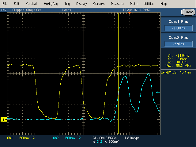

    On the following picture, SDRAM_CONFIG is changed to 0x48805221 (REG_CL = 4)
    The delay is now increased to 3*tCK.

  • Christofer, we are looking into this. Can you answer a few more questions:
    -What is your read latency set to in DDR_PHY_CTRL_1? This should be adjusted along with a change in CL.
    -Where along the trace are you probing the signal? Are you closer to the processor or to the memory?
    James
  • Christofer, one more questions
    Is the scope shot showing a capture of a read or a write?  I believe it may be a read, so you would need to start counting cycles when WEn is high.
    James
  • Hello James
    The traces between processor and memory are about an inch long. The measurement points are about half-way between processor and memory.
    We are pretty sure these are write bursts. The way we deterimine that is by looking at the waveform of DQS0P. It shifts between having two different styles. When the burst has the style seen in these aqcuirements it is always receeded by a /WE pulse, while no bursts of the other style are preceeded by a /WE pulse.
    Given that we were focusing on write bursts, I haven't documented the setting of READ_LATENCY very carefully, but I think it was set to REG_CL +1 in both cases
  • Christofer, is it possible that you are observing a precharge command? Is it possible to capture RAS and CAS at the same time?
    REgards,
    James
