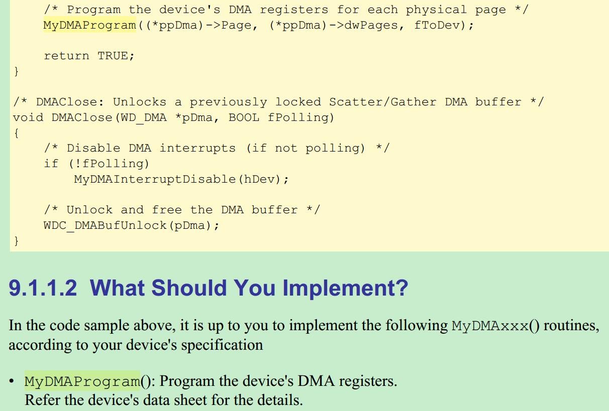

I had used the WinDriver to create one PCIE demo project on Windows Host PC.
And the DSP project is using  C:\ti\pdk_C6670_1_1_2_6\packages\ti\drv\exampleProjects\PCIE_exampleProject.
And now the Host PC PCIE demo project can read/write the DSP BAR1 memory space correctly.
Then I want to implement the Host PCIE DMA to access the DSP BAR1 memory space.
Do I need to modify something based on the project C:\ti\pdk_C6670_1_1_2_6\packages\ti\drv\exampleProjects\PCIE_exampleProject?
For simplicity, I do not use DSP's EDMA to access PC's memory through PCIE.
So I think I do not modify the C:\ti\pdk_C6670_1_1_2_6\packages\ti\drv\exampleProjects\PCIE_exampleProject to accommodate the Host PC. Am I right?
From the WinDriver view, its PCIE DMA demo codes need to write the device's registers like following picture.
Can anyone give some hints about this above?

  • Dear Feng,
    Yes, you don't want to change anything in our PCIe example for EDMA access in RC PCIe device (PC).
    We also have ready made DMA write/read support in PCIe example in latest processor SDK package. So you can also use EDMA at EP side (DSP) too.

    I had a little confuse about the PCIE DMA. I think there are two kind of PCIE DMA, one is PC as the DMA master to read/write the DSP's BAR1 memory space and the other one is DSP as DMA master to read/write PC's memory space. Am I right?
    For simplicity, I do not change my current DSP project and just need to modify PC WinDriver codes to perform DMA.
    Could you give me some hints to use DMA under WinDriver which I mean is PC as DMA master? Maybe you have some experience about this.
