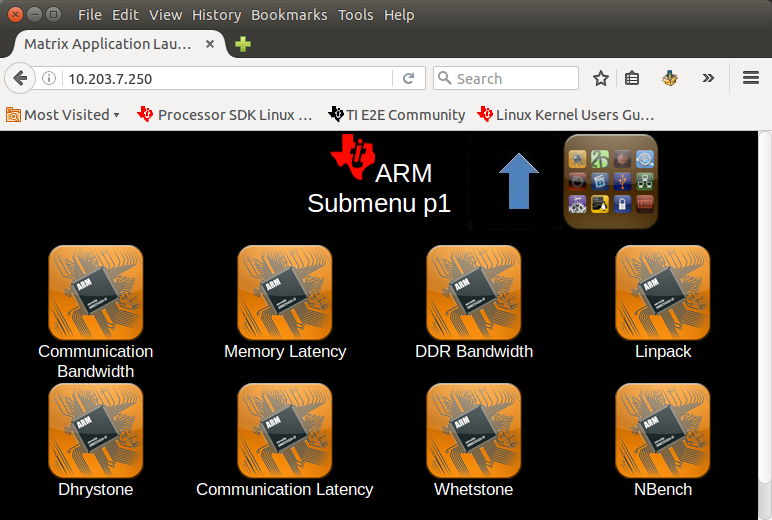

Where is the source code for the <Communication Latency> in the Processor SDK Linux Matrix example?
Hello
I want to find the source code for the communication latency test module showing in the following picture. I went through the ti-processor-sdk/example-applications folder, but I did not corresponding file. (the second figure shows the folders in the example-application). Can you help me to find the source code?
The reason of acquiring that code is: we want to use ARM core to send/receive TCP sockets. As in the <Communication Latency> test, it measure the performance of TCP/IP. So I thought this code would be a good start point for me. We are welcome that anyone can provide me more example codes for our application.
Xining
  • You will not find any source code of this "Communication latency" but binaries & scripts in filesystem.
    You can get the source code of this from lmbench.
    lmbench tool is available in arago source of K2H processor Linux SDK for yocto build.
    processors.wiki.ti.com/.../Lmbench
    When you run communication latency, some scripts would execute and produce the results.
    Checkout in K2H filesystem location.
    /usr/bin/runLmComLatency
    /usr/share/matrix-gui-2.0/apps/arm_communication_latency.
    I hope this helps.
