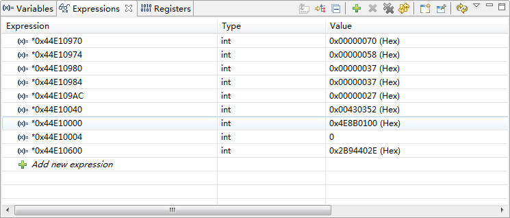

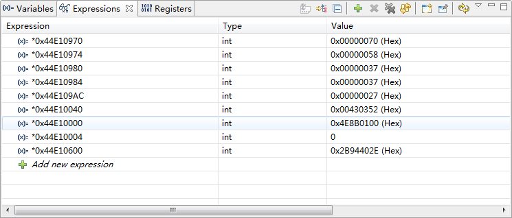

The result of Control Module Register. Is not correct.

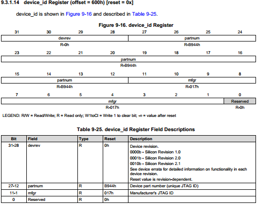

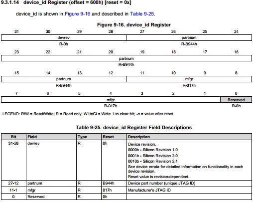

But the Device_Id Register (0x44E10600),is correct , I think that is no problem  about the operation of reading Control Module Register .
