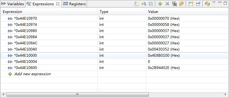

AM335x,Control Module Register cannot be written, only can be read.
I use my board to develop software,  I need to change pin mux, but  I failed to write the Control Module Register.
My code such as:
HWREG(SOC_CONTROL_REGS + CONTROL_CONF_UART_RXD(0)) = 0x0000001F;
HWREG(SOC_CONTROL_REGS + CONTROL_CONF_UART_TXD(0)) = 0x0000001F;
HWREG(SOC_CONTROL_REGS + CONTROL_CONF_UART_RXD(1)) = 0x00000030;
HWREG(SOC_CONTROL_REGS + CONTROL_CONF_UART_TXD(1)) = 0x00000010;
or:
*((volatile unsigned int *)0x44E10970) = 0x0000001F;
*((volatile unsigned int *)0x44E10974) = 0x0000001F;
*((volatile unsigned int *)0x44E10980) = 0x00000030;
*((volatile unsigned int *)0x44E10984) = 0x00000010;
The result of Control Module Register. Is not correct.

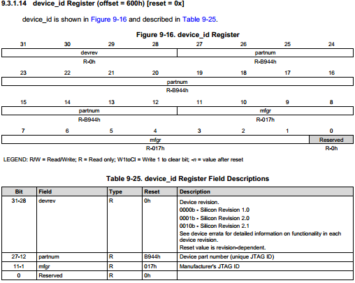

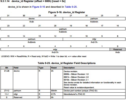

But the Device_Id Register (0x44E10600),is correct , I think that is no problem  about the operation of reading Control Module Register .
Anyone can help me ,Thanks very much.
