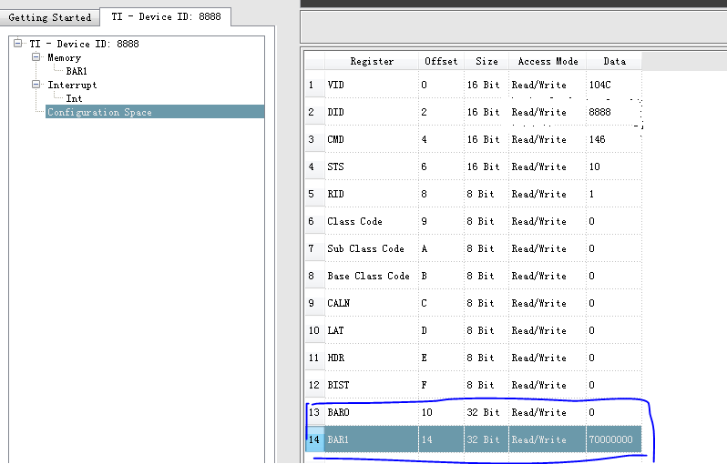

         In order to realize the communication between  DSP and PC via PCIE, I selected the PCIE example which is located in pdk_c6678_1_1_2_6 folder. After the program is loaded in DSP, I needs to restart the PC for enumerating the device.  Then by software WinDriver on PC side I can see the memory space PC distributes to DSP is as follows.
  Here are my questions:
1.In the PDK PCIE example, the BAR1 value is 0x70000000. From the above image, we can see that the value of BAR1 is the same as the one in the program. I think it means the PC does not allocate its PCIE bus address for  DSP. Is this right? Because after the translation steps are finished, I can not find the data in the translation address.Why? Can you give the detailed translation process or result? In the case, the IB_addr(HI) =0, IB_addr(LO)=0x70000000 ,the Offset=0x10820200.
2. If my guess is right in Questions 1, How to configure PCIE to let PC allocate correct PCIE bus address for DSP?
3.If not, that means PCIE  configuration process is right,  WinDriver has error, is another driver needed?
