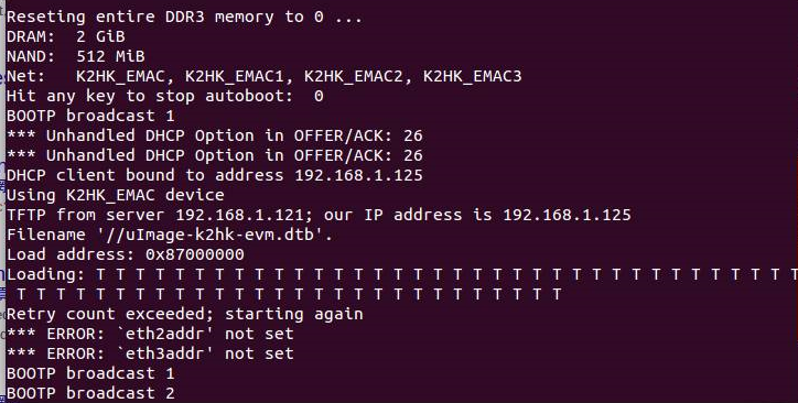

EVMK2H fail to display IP address on LCD screen
I follow the instructions to boot up out-of-box demonstration
The IP address can display on LCD screen a few weeks ago.
Now, i want to install MCSDK_HPC and follow the instruction on the website: http://processors.wiki.ti.com/index.php/MCSDK_HPC_3.x_Getting_Started_Guide
 After  I setted the Environment variables in Uboot of the EVM and then boot ,It failed to load uImage-k2hk-evm.dtb and show some messages
The figure below show my logs which are booting U-boot from ARM SPI mode
Also,the IP address fail to display on my LCD screen ...
Could you help me ?
Thanks !

  • The log seems to be you are trying to boot the device from NFS.
    Please make sure that you have connected the board to server PC(192.168.1.121).
    How did you connect the ethernet cable to K2H board ?
    K2H (192.168.1.125) to PC or K2H to Switch and Switch to PC (192.168.1.121) ??
  • My connection between the PC and the EVM is between a USB port on the PC and the mini-USB on the EVM main board (not the daughter card).
    My ubuntu PC and EVM board connected to the switch and switch also connected to internet of my lab.
    But the LCD screen failed to display IP address . By the way , i am very confused that it could display IP address a few weeks ago ...
    Thanks for your help !
  • My ubuntu PC and EVM board connected to the switch and switch also connected to internet of my lab.
    So, setup is fine, please make sure that no one disturbed the setup.
    If you didn't do anything, then you have to check the ubuntu PC (tftp server) where the tftp server is running and its responsible to load the required images for K2H board.
    Try to restart the PC so that tftp server will restart the daemon.
    Or use this command to restart the server "sudo service xinetd restart"
    Also please make sure that PC IP address is "192.168.1.121"

  • I follow the website:processors.wiki.ti.com/.../Program_EVM_UG
    I use this instruction :$DSS_SCRIPT_DIR/dss.sh program_evm.js evmk2h-le nand
    And IP address : 192.168.1.125 could display on my LCD screen . And then I can see matrix app launcher
    But when i run Multi-core Image processing demo , It seems to stop and waiting for 192.168.1.125...
